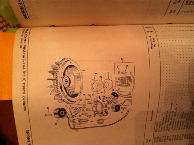

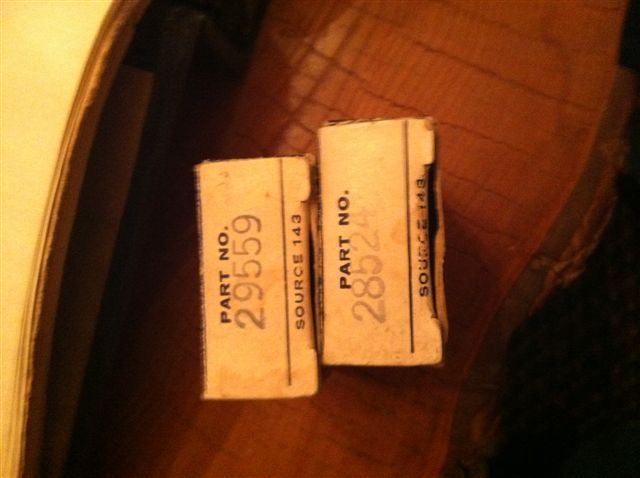

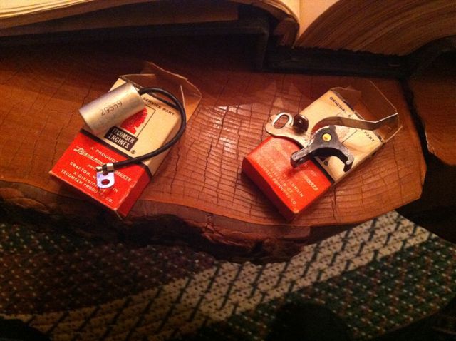

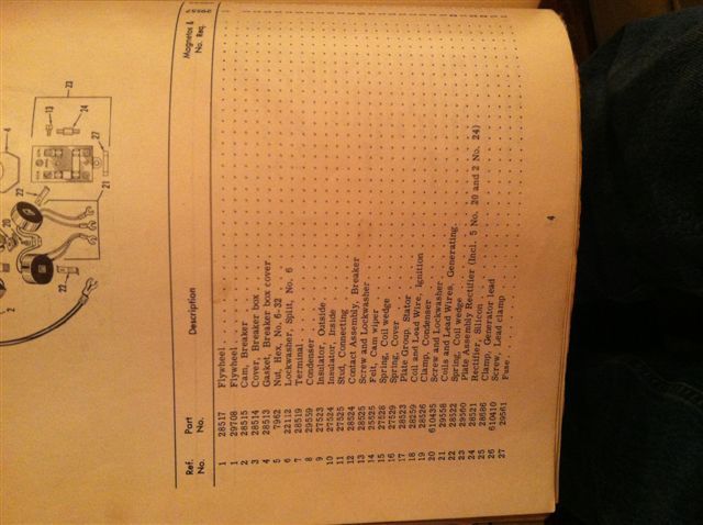

formariz 12,381 #11 Posted January 23, 2014 Your engine should have a WICO 29692(FW2681) magneto. All h55d spec 2113 engines i have do so. Points are Tecumseh part #28524, condenser is Tecumseh part #29559. Both not easy to find. 1 Share this post Link to post Share on other sites
formariz 12,381 #12 Posted January 23, 2014 Incredibly there are quite a few of each on eBay right now. I suggest getting a couple of each. Share this post Link to post Share on other sites
