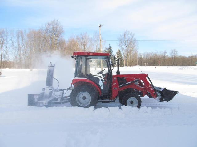

cheesegrader 436 #36 Posted January 21, 2014 I think you are going about this backwards. I bet you spend most of your time on grass, and realatively little of it on frozen concrete. You might get the best tire for the concrete, and regret what it will do to the yard. I agree with Don. Turf Masters, with rubber chains in the winter. Without for summer. For snow and ice, I think chains on a smooth tire are superior to Ags. They shed the compacted snow and ice better than any lug pattern tire. (Don't look at my avitar. My loader has filled Ags, and about #300 pounds of weight. It never goes on the grass. My snowthrower and plow go on the other tractor, with the turfmasters and chains. It has the best traction, and can go anywhere.) Share this post Link to post Share on other sites
