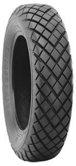

HorseWhisperer 243 #10 Posted January 20, 2014 (edited) Firestone makes a 6-12 turf tire and I had an old set I let go of.There ain't many 6-12 tires out there other than ags so I'm gonna fly with these again! Edited January 20, 2014 by HorseWhisperer 3 Share this post Link to post Share on other sites

Uncle Buck 246 #13 Posted January 20, 2014 Being honest I was not very keen on anything shown. Of what you showed though the Trac Chief was the least offensive to my eye. Personally, I always like the looks of older vintage or more period correct looking tires for my old tractors. When I do buy new tires for a machine (have not so far) I will stick with tires that look like they came on machines sold and used during the 1960's or earlier. Firestone makes a 6-12 turf tire and I had an old set I let go of.There ain't many 6-12 tires out there other than ags so I'm gonna fly with these again! That is a good looking tire to my eye. 2 Share this post Link to post Share on other sites
