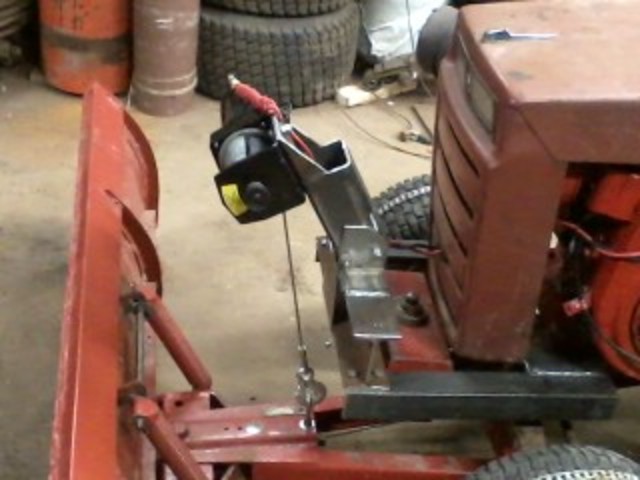

tmix 34 #1 Posted January 15, 2014 OK put a superwinch on the front to lift the plow up & down worked great last week used it for about 1 1/2 hours no prob. tonight used it for 2/12 hours with lights on battery was not charging lights were dim shut them off still ran but winch was SLOW then got slower to the point when i pushed the button it would come up 1/4 inch at a time. ANT help would be great yes it has a good battery & winch motor was not hot. When i shut off tractor i't wouldn't start battery D.O.A Any help would be great thanks guys T MIX 2 Share this post Link to post Share on other sites

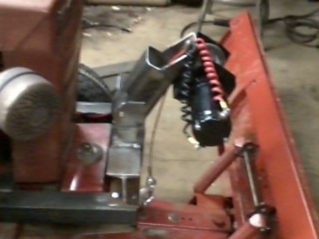

Ed Kennell 46,477 #3 Posted January 15, 2014 Nice fab job. Will the hood open far enough to fill the tank ? Is that a C - 120 ? Share this post Link to post Share on other sites
tmix 34 #4 Posted January 16, 2014 No it's a Raider 12 HP and yes the hood opens far to and gas & check oil there is in the center two blocks of lead painted red with a bolt thru them 65lb thats why the winch is where it's at. Got's to have the weight on them front tires if u want to turn with a plow full of snow =0 1 Share this post Link to post Share on other sites
