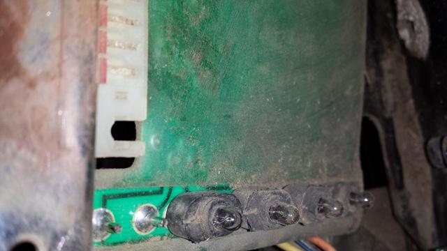

Graeme 7 #27 Posted January 31, 2014 Thanks for straightening me out on the bulbs, I had this mistaken idea that the bulbs were somehow soldered onto the circuit board so I was hesitant to pull one off. I bet I can find one that works at the local auto parts store. Seems like I remember dash bulbs being a similar size. Share this post Link to post Share on other sites
JERSEYHAWG / Glenn 4,590 #28 Posted January 31, 2014 Ok. My ending. Pic of my circuit board. Still looks in ok shape. There are a couple bulbs on ebay. Pricey. About 8 to 9 bucks with shipping. For those looking. I lucked out and found a NEW BULB . Last one he had. 4 bucks. I will keep the old one and suggest others do to. The valuable rubber boot the bulb is in. Find a bulb that will work you still have the rubber boot to push on the circuit board. Glenn Share this post Link to post Share on other sites
JERSEYHAWG / Glenn 4,590 #29 Posted January 31, 2014 UPDATE: I just got a call back from a Toro dealer. Indicator bulb #111331 is still available at a price of $6.00. Just a FWIW and heads up for those looking for the bulb. Glenn Share this post Link to post Share on other sites
