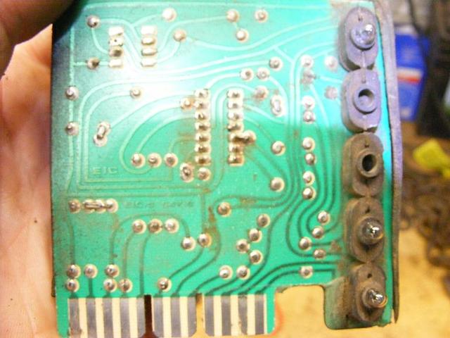

Save Old Iron 1,576 #16 Posted January 17, 2014 Wow guys, I was just going to be happy to have working indicator lights! Yes, but I don't think we can do something that difficult Seriously, take a picture of the front and the back sides of the circuit board along with a third pic of the wiring at the pc connector. We may be able to point you in the right direction toward reapairing the problem yourself. Depending on the symptoms, you may just have corrosion on the pcb that requires repair or you may need to replace a few electrical components on the board. Share this post Link to post Share on other sites

Graeme 7 #19 Posted January 17, 2014 Ok, Here is a pic. SOI, I took the board out and it seems pretty clean. I am reluctant to remove the protective rubbery stuff on the back of the board, I pulled on it a bit and it is wrapped right around all the resistors and stuff on the back of the board. I'm afraid if I pull too much the resistors may stop resisting. At this point I would like to maybe start by replacing the bulbs, are they a simple two prong style bulb that just plugs in? As you can see two are missing. Share this post Link to post Share on other sites

Save Old Iron 1,576 #21 Posted January 31, 2014 (edited) Or do you push the new bulb in and bend the legs to the side Glenn The new bulb can be inserted into the old rubber housing (legs of the bulb bent as follows) 12 volt "Grain O' Wheat" bulbs can be used. Radio shack may carry the bulbs or possibly any hobby or train store in the area. http://www.ebay.com/itm/SHIPS-FROM-USA-10-pcs-4-7mm-clear-12Vdc-grain-of-wheat-mini-lamps-bulbs-12-v-dc-/230851469825 Edited January 31, 2014 by Save Old Iron Share this post Link to post Share on other sites
Save Old Iron 1,576 #22 Posted January 31, 2014 When you remove the rubber holders, check on the circuit board under the holders for corrosion / erosion of the copper traces Share this post Link to post Share on other sites
Save Old Iron 1,576 #24 Posted January 31, 2014 (edited) wet grass clippings captured under rubber holders turned to acid and ate away copper traces on the indicator board Edited January 31, 2014 by Save Old Iron Share this post Link to post Share on other sites
