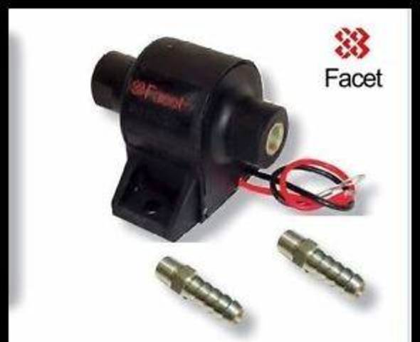

wheeledhorseman 579 #5 Posted January 13, 2014 This is the Facet I fitted to my D-200 and another to my 316 Its the low pressure 1.4 - 5 psi type - no problems on either tractor in fact give these a second or two to fill the float bowl and the tractors fire up on the button. Andy Share this post Link to post Share on other sites
JC 1965 1,534 #6 Posted January 13, 2014 Hi, thanks! I also did some topic searching here and found a thread about the Purolator Facet model # 04SV... Maybe somebody will have another idea but so far one of these 2 pumps looks good and there both $35... Tony Tony, I have been using the facet model # 04SV on two of my Wheel horse tractors for about 2 years and they work great. They are rated at 1.5 to 4.0 PSI and are recommended for use on all kinds of small engines small from boat motors to generators. Should work great for you. Hope this helps. Share this post Link to post Share on other sites
Marv 994 #7 Posted January 15, 2014 Tony, I have three tractors using the Facet pump. Works great for me. Marvin Share this post Link to post Share on other sites
rick 270 #8 Posted January 16, 2014 I have two tractors equipped with Facet pumps, one from NAPA, the other from Kirk Engines. I recommend 'em! Share this post Link to post Share on other sites
squonk 45,340 #9 Posted January 16, 2014 Napa # is 610-1051. The pump is a Facet. Got one in my C-160 for 2 yrs. now Share this post Link to post Share on other sites
