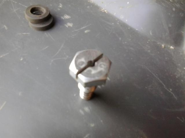

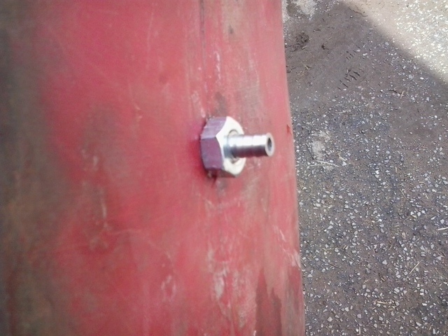

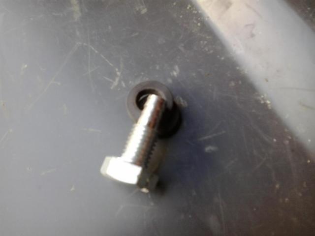

Bobie01 22 #1 Posted January 12, 2014 Hello. the tank connection form my Raider 10 was broken so I made myself a new . With my lathe this was not a problem. I drilled a hole in an M8 screw and turned off a piece to the diameter of 6 mm. In the head of the screw I sawed a bit. The tank was quickly reparet and only cost me a screw. 2 Share this post Link to post Share on other sites
