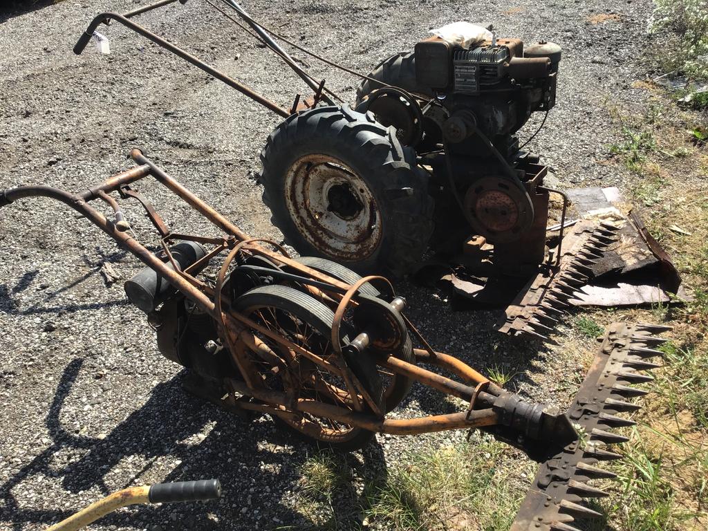

Denny:

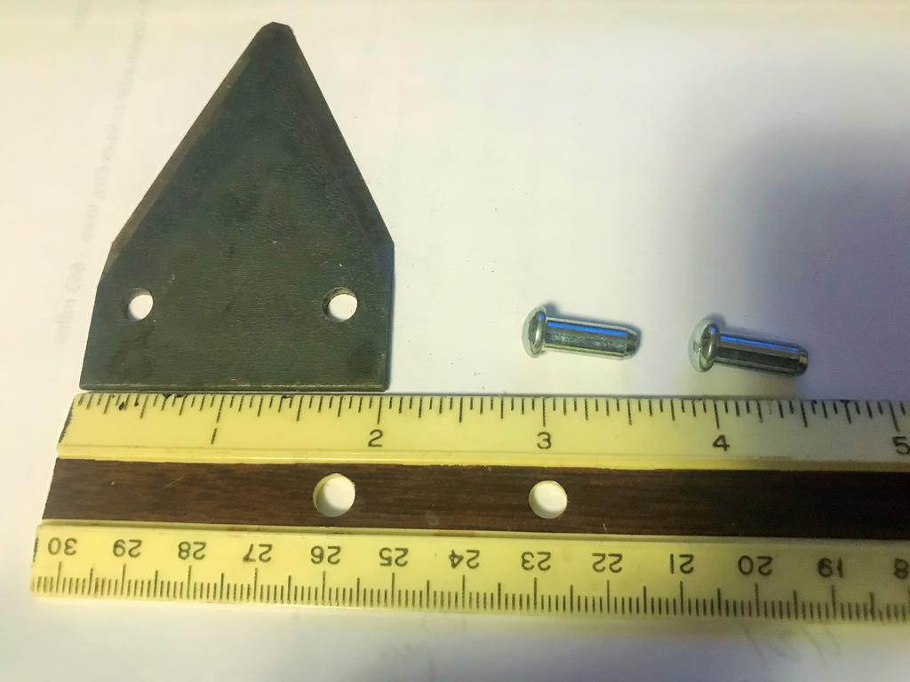

I see Webb Sickle Service in Nebraska changed their name to Webb Cutting Components, Inc.    They still have the correct 2 inch replacement sickle bar mower blades that fit the Wheel Horse  front cutter bars (for RJ's and Suburbans) and the 42 and 50 inch Wheel Horse sickle bars.    FYI
https://www.cuttingcomponents.com/jari-replacement-section-102500-2-w-x-2-13-16-h-3-16-hole-on-1-3-8-centers.html
Edited by Lane Ranger
  • Like 3
dclarke
1 minute ago, Lane Ranger said:
Denny:
Thanks for the info, Lane. Those blades are hard to find. I sold my sickle bar a couple of years ago.
Lane Ranger
They fit the CBR-32  front sickle bar too Denny!
  • Like 1
Pullstart
14 minutes ago, Lane Ranger said:
Denny:
Thanks, Lane!  I have Jari and David Bradley sickle mowers, been thinking about building a front mower for my 502 out of one of them. Most likely the DB, as I’ve used the wheels and tires for my Frank build and the drive pulley is on the correct side for the :wh: PTO.

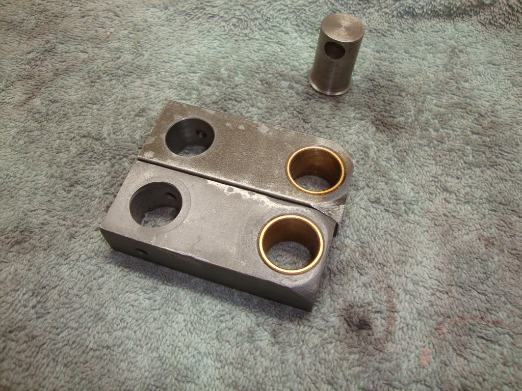

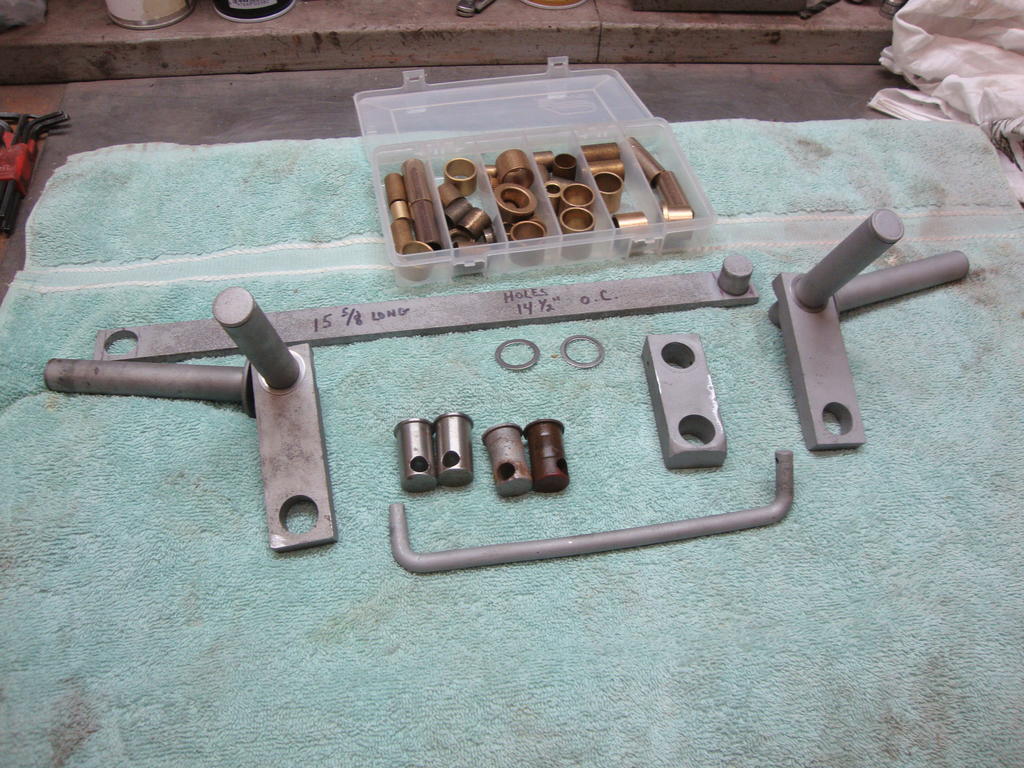

Sarge

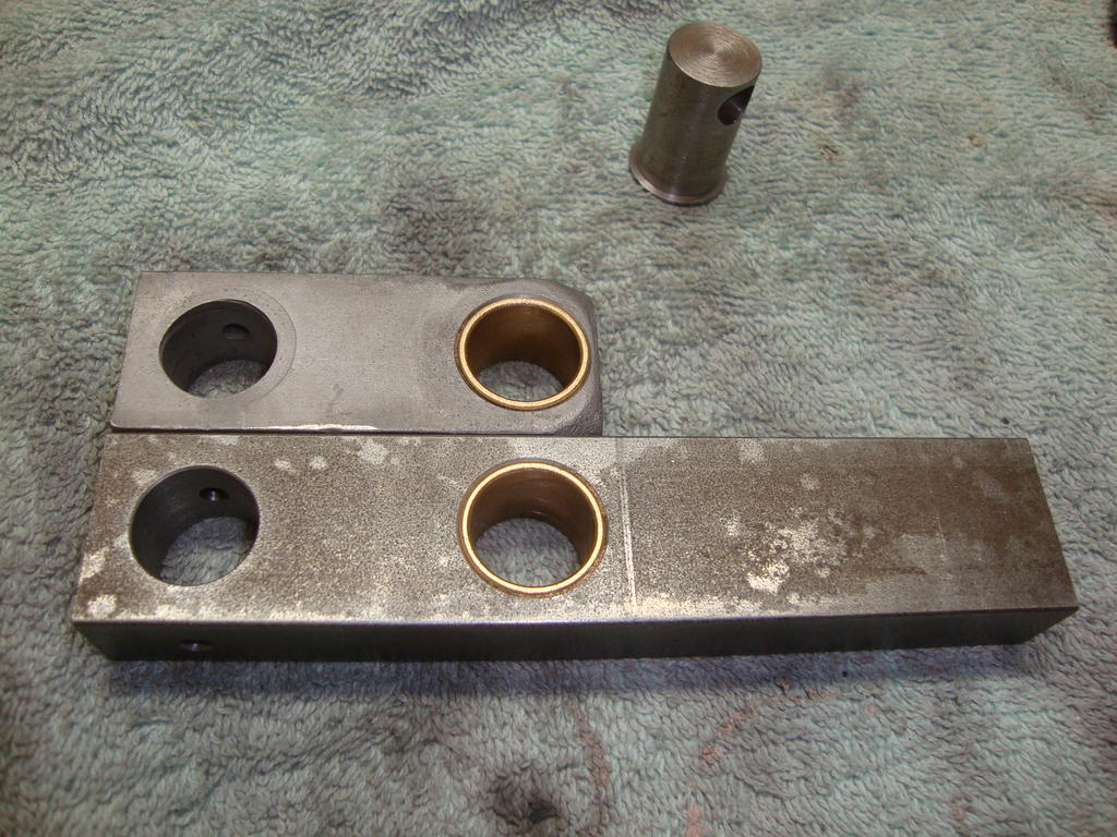

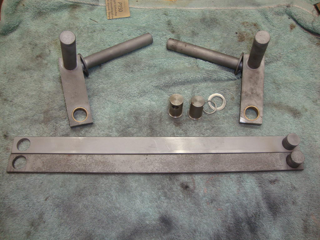

Just fyi - there are some very thin bronze washers/bearings available from McMaster for additional wear point protection. You could also just use brass shims if there isn't enough room.
Sarge
  • Like 1
dclarke
Sarge
Thanks Sarge, I’ll check that out.

BTW that will steer nice with those bushings, I did similar on a few builds and steer better than new! :handgestures-thumbupright: Well worth the effort.
