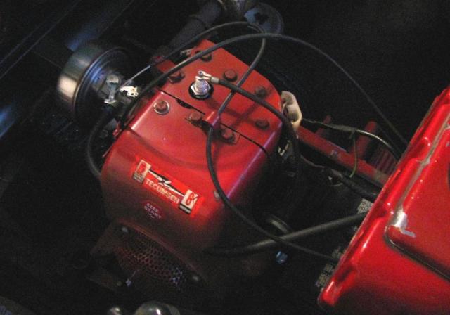

AMC RULES 37,259 #21 Posted August 17, 2014 Pictured is the HH-60 Tecumseh Gary...from my 653. I've read about that dial gauge, but to date, haven't seen one. Share this post Link to post Share on other sites
Retired Wrencher 6,941 #22 Posted August 17, 2014 Pictured is the HH-60 Tecumseh Gary...from my 653. I've read about that dial gauge, but to date, haven't seen one. very nice 653 Craig. There I think 2or3 on u no where begins with an E. I would like to try this for tune ups. And there not much $$$ I have all the manuals for them now so it should be fun. take care Gary B... 1 Share this post Link to post Share on other sites
AMC RULES 37,259 #23 Posted August 17, 2014 Thank you Gary... I see them now. Share this post Link to post Share on other sites
