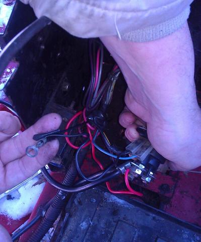

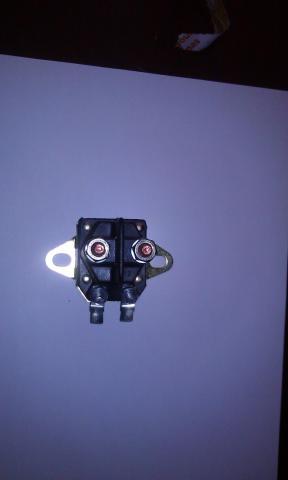

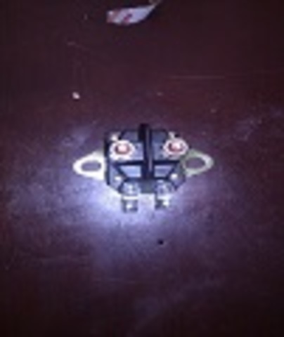

epro 0 #1 Posted January 4, 2014 I have posted on this forum that I need help with the electrical problem on one of my tractors, it is a toro / wheel horse 210-5 (model: 32-10B502) and (serial: 1020167). Let me start all over and start a new thread. I have included some pictures of what I want to do. I need to know how to wire this lawn tractor up from an OEM Solenoid to a Universal Solenoid. Sorry to say that I do not understand the manuals directions on how to wire the tractor up to a solenoid. I need information on how to wire the solenoid that's attached to the tractor in the picture, To the Universal Solenoid that is not attached to the lawn tractor. the first two pictures are the universal solenoid, and the others are the oem solenoid. Please explain it to me in layman instructions. See how the solenoid that's attached to the tractor, the two big poles are going Vertical and the two small poles are going Horizontal. While the Universal Solenoids poles are Horizontal. That is why I don't understand how to wire the universal solenoid up. Sorry for the misdirection. Share this post Link to post Share on other sites
rmaynard 14,950 #2 Posted January 4, 2014 Doesn't matter about the big lugs. One gets the big wire from the battery, the other gets the big wire from the starter. The small lugs are for 12 volts from the switch and ground. One should be marked + and the other -. If not, it doesn't matter. The + lug (if marked) gets the light blue wire, the other goes to ground via the black wires. Share this post Link to post Share on other sites
