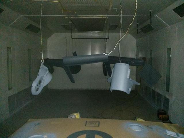

AMC RULES 37,260 #26 Posted January 21, 2014 The old guy got stripped down to his birthday suit today to get ready for paint. Most of the sheet metal got blasted today, the rest tomorrow followed by a coat of epoxy primer. The rest of the tractor will get rolled into the blast booth and blasted also. Nothing beats getting paid to restore a tractor! Share this post Link to post Share on other sites

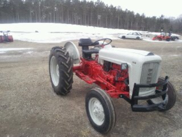

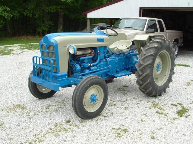

Bluffhunter 39 #27 Posted January 21, 2014 These pictures are of the 1958 841 Ford Powermaster I rebuilt through the Winter 2 years ago. I bought it from the original owner. The blue looks lighter in color, than it really is, because the sun is reflecting off the chat, I guess. 3 Share this post Link to post Share on other sites
AMC RULES 37,260 #28 Posted January 21, 2014 Very nice restoration. 1 Share this post Link to post Share on other sites

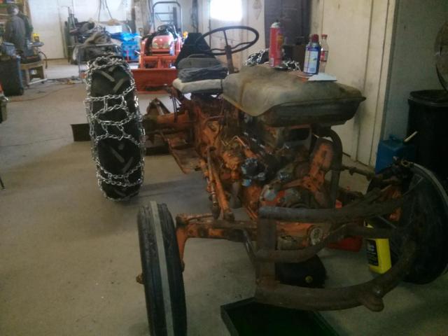

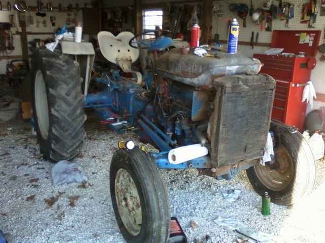

roscoemi 245 #29 Posted January 22, 2014 Nice job. Looks like the same as the one I'm working on except sheet metal and front bumper, no power steering and a different trans. This one is painted orange, has an id tag riveted to the right fender and a tubing seat frame. Gut feeling is that it was born as a MDOT tractor for the state, but will probably never know as the po has passed. Craig, I'll get some pics tomorrow. But not close enough to show a couple runs in the primer from the rookie spray jockey! I may also get a few of the building's owners toys. 2 Share this post Link to post Share on other sites

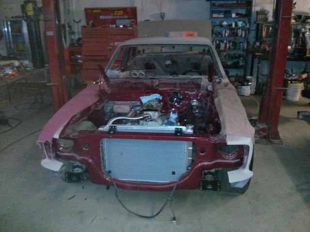

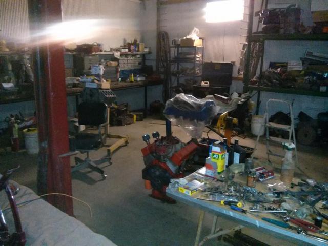

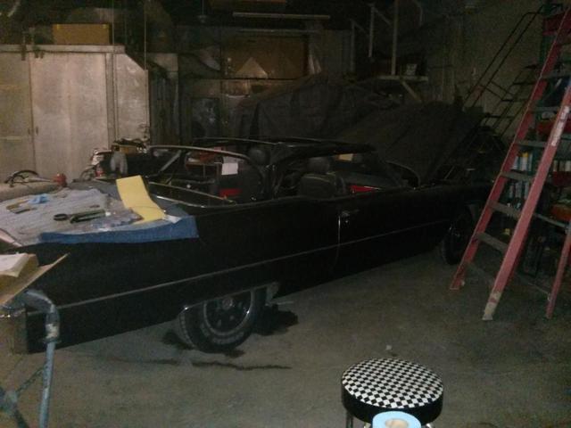

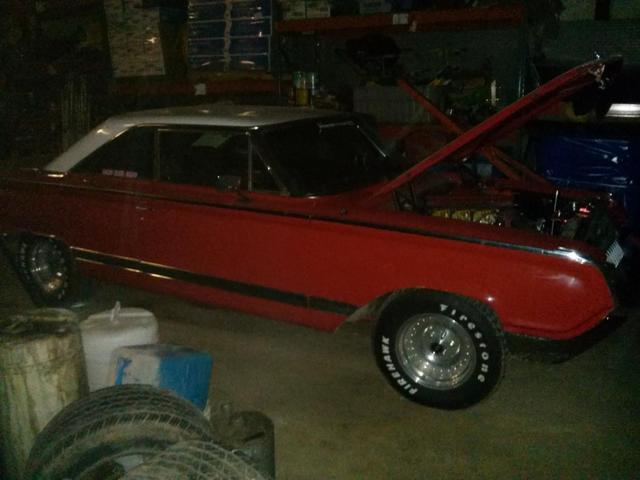

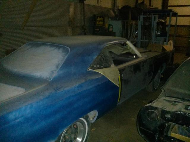

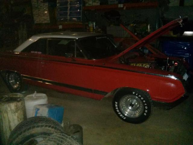

roscoemi 245 #30 Posted January 23, 2014 Here's a couple pics from yesterday, the only things left to remove is the gas tank and stands. They came off today and into the blast booth it went. I got it about half done when the sand turned to talcum powder. I'll get some more in the morning and may get it all done tomorrow and get some pics of a Ford in bare metal, the sand gives it a dull silver look. Now for the toys A 1969 Caddy drop top with a worked 472, in the process of getting a new white top A 1964 Merc with air and a big block with 3 deuces that was a Long Haul member for the 2011 Hot Rod Power Tour A 1968 Road Runner with etched quarter glass Mid seventies Nova with circle track suspension, 600+ hp 400, 4-speed and quick change rear. Bare block is a 383 for the road runner, the red one is a dirt track motor with aluminum Pontiac NASCAR heads and other dirt motors. It's a pretty cool place to hang out and restore a tractor I guess! 2 Share this post Link to post Share on other sites

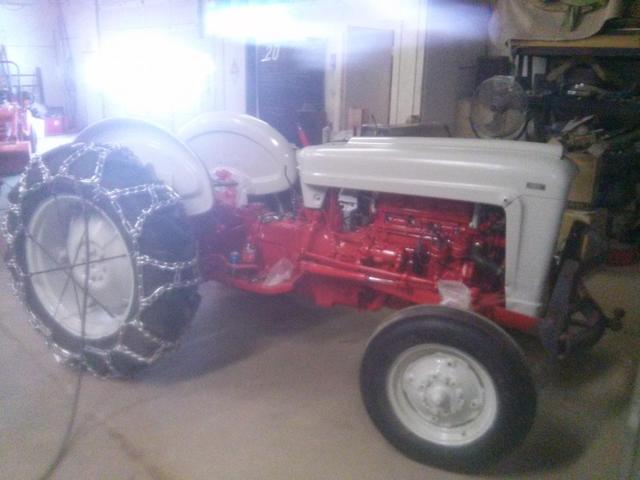

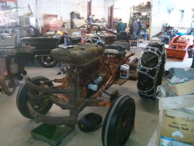

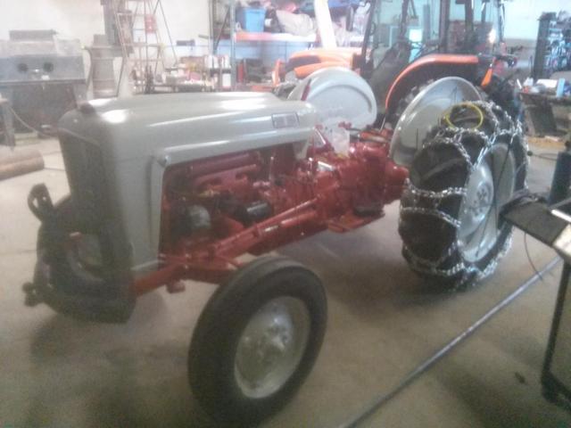

roscoemi 245 #37 Posted February 2, 2014 Never been a good speller Craig! Anyway here he is. I just need to order the new gauges to assemble the dash, assemble the throttle assembly and fab a battery box. When it gets warm the front bumper will get a make over. The Kubota in the background burned up it's pto clutch in about 50 hrs due to lack of hyd pressure from the factory, may have to split that one and fix it due to Kubota's attitude. 2 Share this post Link to post Share on other sites

SousaKerry 503 #40 Posted February 8, 2014 (edited) Nice thread wish I would have found it sooner. I grew up with my hands and butt firmly attached to a pair of 960's and an NAA. Dad runs 12v batteries all the time in them with nothing converted they hold up just fine just don't charge. Another option is they make a 9 volt battery hard to find but they will charge on a 6v system just fine. Old guy looks great in original grey and red. Blue was good but I prefer the red. Edited February 8, 2014 by SousaKerry Share this post Link to post Share on other sites
Bluffhunter 39 #41 Posted February 8, 2014 Looks GREAT !!!! Bet those new chains set you back a couple of bucks ! Wish I had chains for mine ! Share this post Link to post Share on other sites
roscoemi 245 #42 Posted February 8, 2014 I tried talking the boss into crème and red, those are sharp. The generator was questionable so we put a one wire alt on it. The gauges needed replacing anyway so it will get 12v versions and led lights front and rear. The chains were on sale at TSC, a return I believe, and the boss talked some poor guy into around $110 a piece. I can't remember the exact number, it's in the first page of this thread. The new gauges should be here by weeks end. I ended up splitting the bigger Kubota today to find the part that transfers power from the engine to the clutch basket for the rear pto slid back on the drive side, disengaging clutch discs as it went until it was flopping around on the shaft behind the splines transferring nothing. There is no obvious way to retain this part in the clutch basket, maybe a spacer on the drive shaft? Hey Craig, I'm getting paid to work on tractors! LOL Share this post Link to post Share on other sites

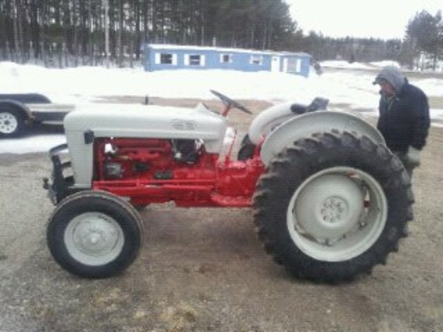

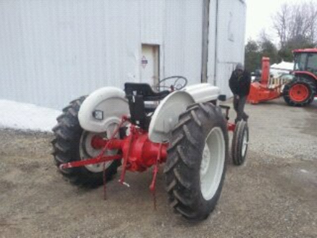

roscoemi 245 #45 Posted April 3, 2014 We got the old girl out of the shop for a little exercise, seemed to run well. The fuel sending unit will have to be replaced, an air filter fabricated and the goofy square lights replaced. Other than that it's done. 3 Share this post Link to post Share on other sites
Desko 687 #46 Posted April 3, 2014 Looks really good like new. Share this post Link to post Share on other sites

Jake Kuhn 1,600 #48 Posted April 3, 2014 Turned out great! Share this post Link to post Share on other sites
Bluffhunter 39 #49 Posted April 3, 2014 Turned out great Roscoemi !!! I need to get a rear facing light like you have on your fender, on mine ! That would be very handy ! Have fun with her !!! Share this post Link to post Share on other sites
roscoemi 245 #50 Posted April 3, 2014 Thanks for the comments guys! Terry, I really doubt that you can kill these old Fords. This one sat outside and forgotten for a few years, and was run without an air cleaner for who knows how long. I put fresh gas in it and a battery and it fired right up, and runs like a sewing machine after cleaning the carb. A cool thing is that you can go to Tractor Supply and they have parts on the shelf for these, from tune up and cab kits to steering wheels! They had that suspension seat for $80, may have to put one on my C-121. 1 Share this post Link to post Share on other sites
