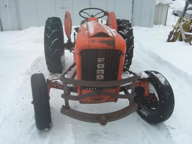

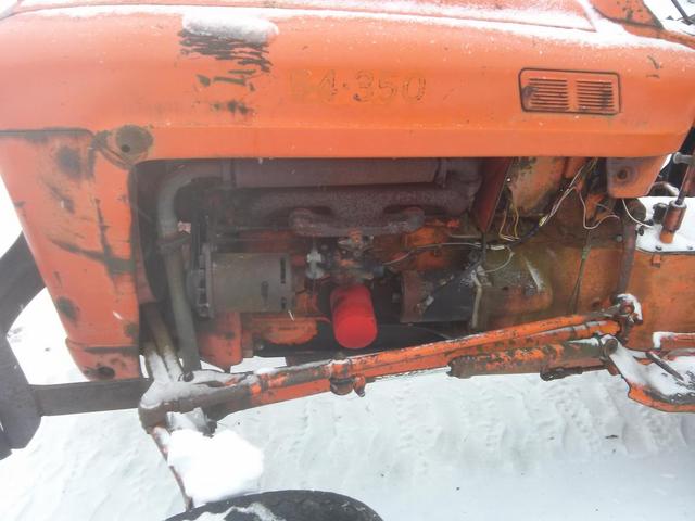

roscoemi 245 #1 Posted January 4, 2014 I spent yesterday in single digit temps and wind to dig this old guy out of the snow. My boss got it from his girlfriends mother for scrap price, I'll probably get stuck getting it going again. Not sure if I should be or ? Not much info on it other than it was parked and the battery removed, then the husband passed on and it has not been run in a couple years. The plug wires look new and the right rear tire is new, somebody did use it and put some money into it. The serial number on the engine is on a horizontal surface facing up and rusted. There are faint shapes in the corrosion so maybe some black paint and a sanding block will make them stand out better once I can get it into the shop. The shifter rotates about 90 degrees, with three detents. Forward, neutral and reverse? Numbers cast into the left front of the block at the bottom. There is a f inside a c then 3d4. Just to the right is a 2. Casting on the right side of the block. Any help identifying this old guy would be very much appreciated. 1 Share this post Link to post Share on other sites
Sparky-(Admin) 26,267 #2 Posted January 4, 2014 Cant help you with ID'ing it but I do know its one lucky tractor. It always sucks when you hear about the old iron going to the scrap yard. Good luck getting her going! Mike.......... Share this post Link to post Share on other sites
AMC RULES 37,259 #3 Posted January 4, 2014 Neat ol' tractor... what was the scrap price of a tractor like that? Share this post Link to post Share on other sites

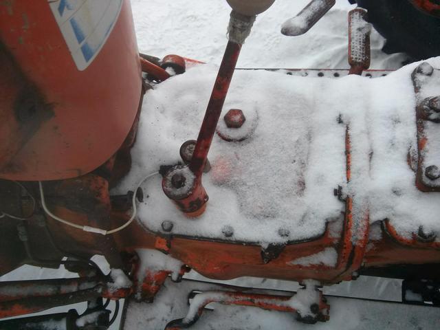

dodgemike 52 #4 Posted January 4, 2014 Those shifters are different. At Each detent it moves up and down Giving you three speeds. That Could be a Continental Red Seal. I thought Ford built all their own Motors but... You could tarp it And build a fire under the pan With charcoal. An old timer showed Me a trick of unhooking the generator and stick a 12v battery In it. That will get her turning over! Sent from my SCH-S720C using Tapatalk 2 Share this post Link to post Share on other sites

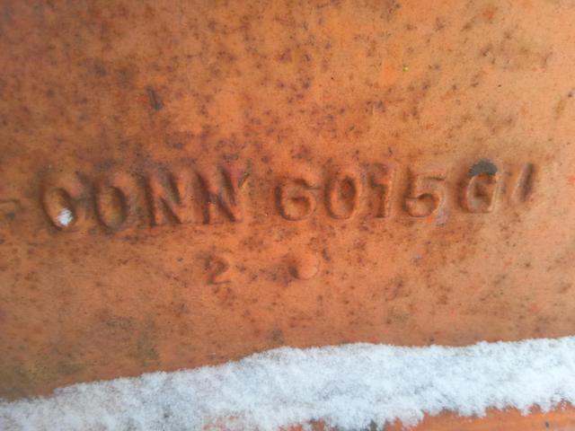

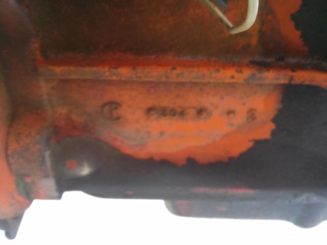

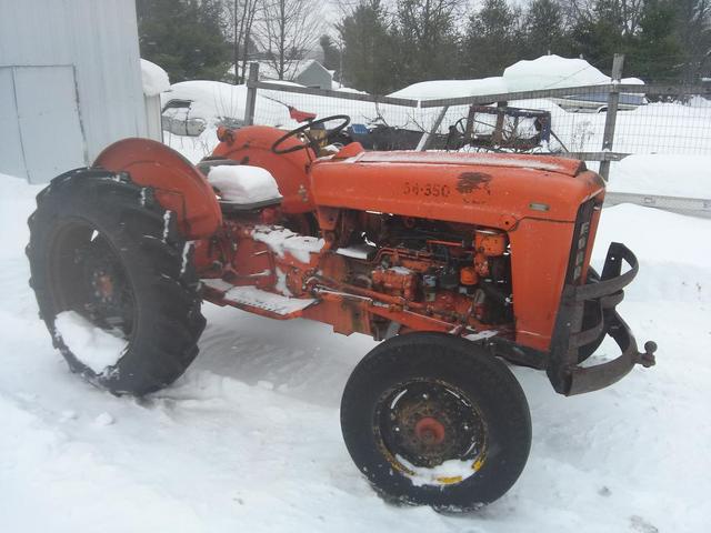

TT-(Moderator) 1,173 #5 Posted January 4, 2014 The casting number on the block denotes a 134 cu in engine - which I'm guessing means that it's a 2000. (The 4000 should have the 172 cu in engine) http://www.oldfordtractors.com/identify.htm The shift pattern is odd, but you have to imagine a modified 5 speed pattern turned sideways to understand. The tractor is up / middle / down ~ twist left / twist right LT RT Up - R 3 Mdl - 1 2 Dn - 5 4 The shifter is in the up position while in neutral - which is perfect on loader tractors because that's 3rd & reverse. To get 1st & 2nd, you push halfway down and swing left or right 4th & 5th are "at the bottom" and then left or right. Share this post Link to post Share on other sites
shorts 182 #6 Posted January 4, 2014 (edited) It doesn't look like a Continental Red Seal from here, they usually had the distributor sticking out of the head or a magneto on the front timing gear drive, Ford built some excellent industrial engines, some that were adapted to automotive use and they excelled in that arena too. If you can raise the serial numbers from the engine that should help identify it. Tractor Supply should have tune up parts and possibly some specs for it. Yesteryear tractor forum will probably have tons of info and resources and TT has the info while I was trying to be helpful Edited January 4, 2014 by shorts Share this post Link to post Share on other sites

TT-(Moderator) 1,173 #8 Posted January 5, 2014 I think the link in my first post will work now. I'm definitely not brilliant when it comes to these, but I have spent some time around a few models. When I was younger, my pap had an 861 Powermaster. My uncle has several 800/900 series tractors - including two diesels. Those tractors are all straight 5 speeds, so that's why I posted the info for that pattern. That doesn't mean the one you're working with is too. Two years ago I spent a lot of time with a 9N and did a lot of studying. It was winter - and actually quite interesting - so I read a lot. We have a '74 3000 Diesel and a '93 3930 at work. 1 Share this post Link to post Share on other sites
roscoemi 245 #9 Posted January 5, 2014 I checked the site, was there last night also, and believe you are correct with the 134 cube engine. There is only one trans code listed for both hydro and pto and it would be a 4 speed. I'll see as work starts on it. As a side note, I joined another forum to get more info on this unit. After 45 min I thank every person running this place to make it what it is! Ya'll are the best!! I've never had a more frustrating time than being over there, and will never go back. Share this post Link to post Share on other sites

roscoemi 245 #12 Posted January 5, 2014 Shorts, I HATE Clark fork trucks. Their engineering is Lol! I've mentored a couple young bucks over the years, it's a sight to see when they get the AHAA! moment that brings everything into focus and then take off running! I'll disconnect the generator and crank it on 12v to get it started and see what we have. If everything is good it will get converted as it will be a worker. The self exciting 1 wire alternator and 12v coil is probably the way we will go with points. I do know that the scrap man will not see this one in his lifetime if we can help it. Share this post Link to post Share on other sites

roscoemi 245 #16 Posted January 8, 2014 I put the starter on yesterday and got 2 ten second cranks out of it before the separate solenoid gave up the ghost. Put a new solenoid on today and got nothing. A hot wire to the coil, and another to the starter fired it up in 3 seconds! It ran quiet and smooth on full choke, so tomorrow it will get a one wire altenator and some minimal wiring for start and run circuits to bypass everything else, and a fuel system cleaning. 1 Share this post Link to post Share on other sites

roscoemi 245 #20 Posted January 9, 2014 I got the starter and ignition circuits wired today, in the process finding that the parts guy gave me a self grounding automotive solenoid instead of the industrial version. Pulled the adjusters on the carb and shot carb clean in the holes and cranked it up. The old guy starts RIGHT NOW! Lol I took it out to play in the snow and found that the idle circuit works fine, but the main jet is not doing it's thing. Will pull the carb and give it a good cleaning tomm. 2 Share this post Link to post Share on other sites
roscoemi 245 #21 Posted January 16, 2014 Got the carb off, cleaned and put a kit in it. The only thing usable from the kit was the float needle and seat and the measuring cardboard for the float height, the rest of the parts were for a carb 50% bigger and different configuration. After removing the dead maggots and weed refuse from the updraft carb, the starter refused to engage properly. The rebuilder replaced the bendix with the correct one and it cranked up and took throttle like it should. After snatching a 3 point blade from the buildings owner, the boss drove 3 blocks home to plow the 12" of snow we got last night. The old dude runs like a champ, just needs some chains for moving the snow with an ice base. Next up will be replacing and rewiring gauges, but it's another save from the dreaded scrapper. Share this post Link to post Share on other sites

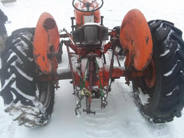

roscoemi 245 #23 Posted January 17, 2014 The old guy got rear chains with the boxes between the cross overs and some tri ribs today. Chains were $250 ea at Tractor Supply, but the boss bs'ed somebody into selling them for $110 ea. The power steering pump needs rebuilding, but may never happen as it steers pretty easy with the tri ribs. The rear tire should be in next week and put on, then the rears will be loaded making it into a snow moving machine. Share this post Link to post Share on other sites
roscoemi 245 #24 Posted January 21, 2014 The old guy got stripped down to his birthday suit today to get ready for paint. Most of the sheet metal got blasted today, the rest tomorrow followed by a coat of epoxy primer. The rest of the tractor will get rolled into the blast booth and blasted also. Nothing beats getting paid to restore a tractor! 1 Share this post Link to post Share on other sites
