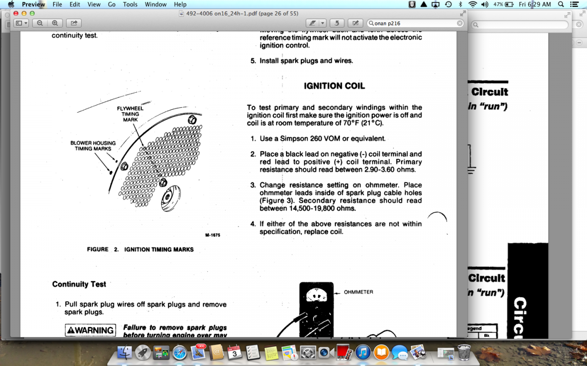

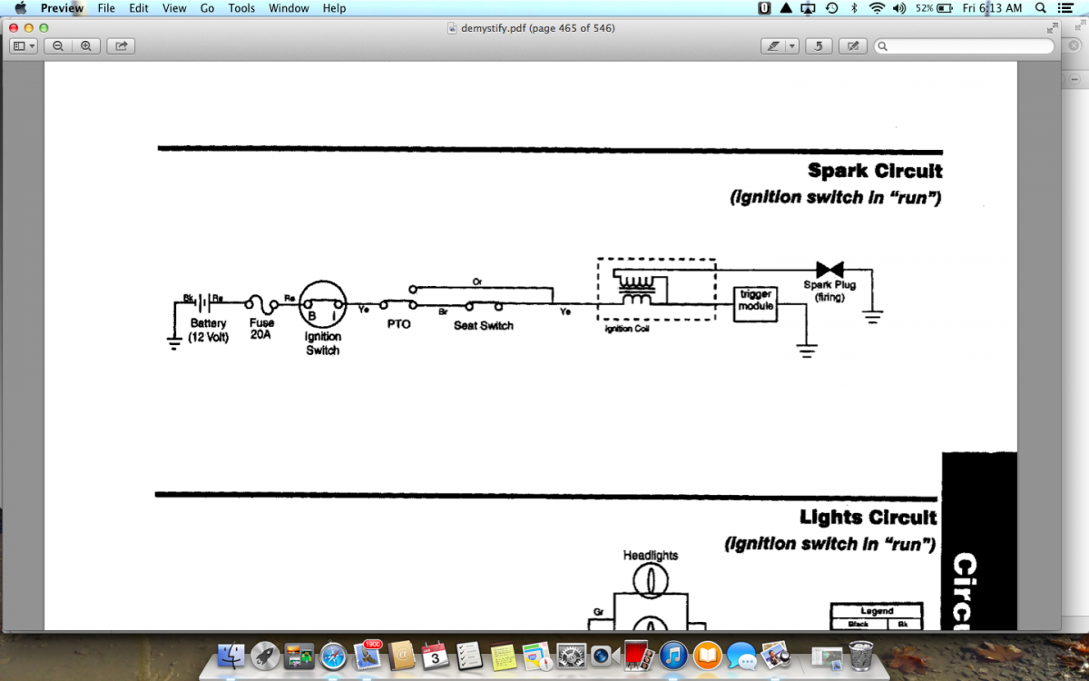

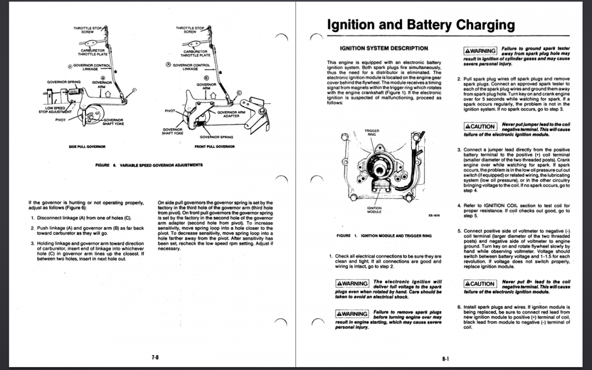

Martin 2,130 #2 Posted January 3, 2014 (edited) looking at the spark circuit for 1988 520 from the demystify manual i would go through each electrical component to eliminate. fuse, ignition switch, pto, seat switch ignition coil. easiest way for me is with a voltmeter and start from the fuse and work your way to the coil. could be just a connection, so move them about, even disconnect and clean the terminals if they need it. most of the time its a connection not making contact. if you get to the coil and trigger module and need to test them, the manuals have a quick test for those too. coil...... module..... i hope its just a connection or a fuse. the coil and module are an expensive fix...... Edited January 3, 2014 by Martin Share this post Link to post Share on other sites
Martin 2,130 #3 Posted January 3, 2014 these manuals are in the forum manuals section....... Share this post Link to post Share on other sites

TT-(Moderator) 1,128 #8 Posted January 4, 2014 The module is behind the flywheel. Have you checked for battery voltage at either small terminal of the ignition coil? {with the key in the run position} Share this post Link to post Share on other sites

TT-(Moderator) 1,128 #10 Posted January 5, 2014 If you check for battery voltage at the ignition coil and it isn't there, then you know it's something on the tractor. If there is power at the coil, then it's either the coil or the module. My 416H required wiggling of the ignition switch plug on occasion and I also had problems with the Molex connector between the tractor and engine harness. Hopefully it's just a loose or dirty connection on your tractor. Share this post Link to post Share on other sites
Torino 14 #11 Posted February 4, 2014 Forgot to report back. It ended up being one of the connections to the pto lever. Share this post Link to post Share on other sites
