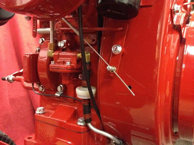

Jrblanke 976 #1 Posted January 1, 2014 I have not been able to find any pictures of the linkage in the manuals I downloaded. Can someone post some pictures of what the linkage is supposed to look like? Currently, the lever in the 1st picture (that is unbolted) is binding on the bolt that was holding the wire that goes to the coil. I was going to try to put another spacer between the engine cover and the lever, but it is already spaced out about a half inch. Anything look wrong with the linkage? Thanks, James Share this post Link to post Share on other sites

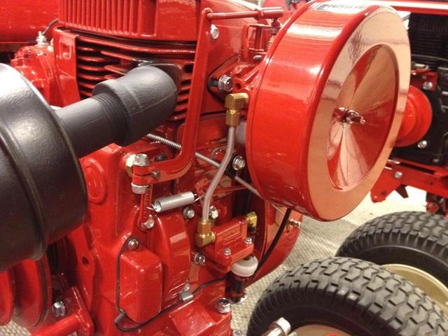

Martin 2,134 #2 Posted January 1, 2014 (edited) does this help? Edited January 1, 2014 by Martin 2 Share this post Link to post Share on other sites

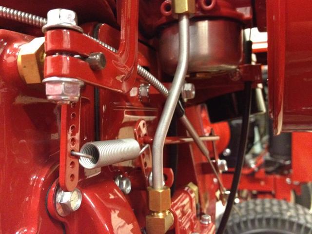

Jrblanke 976 #3 Posted January 1, 2014 Yes, it sure does, Looks like maybe my cable and rod were reversed on the lever. What does the linkage look like up at what I believe is called the governor ( The L shaped lever). Share this post Link to post Share on other sites
Martin 2,134 #4 Posted January 1, 2014 added some more pics.... Share this post Link to post Share on other sites

Jrblanke 976 #9 Posted January 1, 2014 Martin, thank you very much for the help! That is exactly what I needed! I got the throttle hooked up and then the choke cable broke Share this post Link to post Share on other sites
