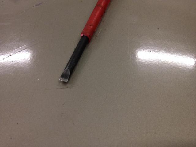

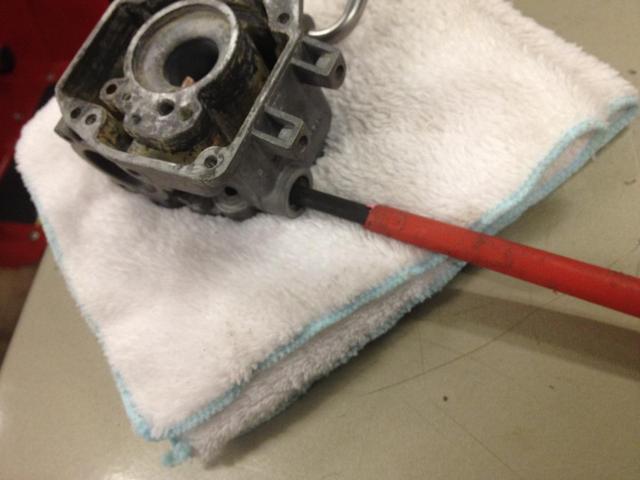

Martin 2,133 #4 Posted January 1, 2014 make sure to try and remove the main jet as well. you need to remove the hex head plug on the side of the bowl first, then use a nice tight fitting screwdriver to remove the jet. i found on of those larger insulated electricians screwdrivers had the perfect size tip. had to remove some of the insulation on the shaft so that it would pass through the hole in the side of the bowl..... Share this post Link to post Share on other sites
