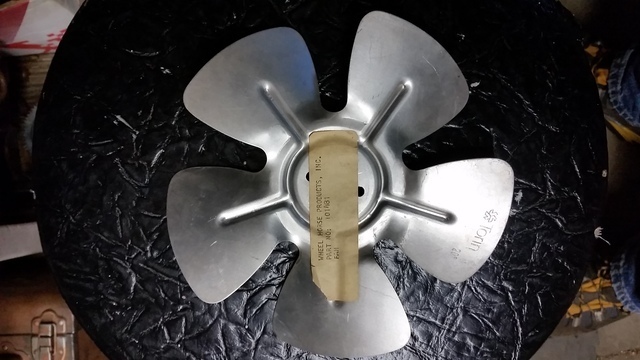

Theroundhousernr 590 #3 Posted December 31, 2013 Thanks for the welcome. I have thought about doing just what you said but I'm not sure which pulleys will fit , or the diameter. Also as you said, will it move enough air. I was hoping some fellow gt14 collector would have the original tin fan, or no of a suitable replacement. Thanks Kyle Share this post Link to post Share on other sites
Theroundhousernr 590 #4 Posted December 31, 2013 OK so quick update. I had some time to pressure wash the rear end and drain the trans fluid. To my surprize there was only a little over a quart of oil in the transaxle. YIKES. After looking at the pulley , it is the same one pictured up above on Stigians gt14. However it looks as though a fan still mounted to the back between the pulley and pump. I say this because there is little allen screw on the back of the pulley. So I feel a a little better that it has some airflow atleast. It took forever just to get the pump to become warm to the touch today. Is having the cast fan pulley good enough or should I keep looking for a aluminum fan or figure out something else?? Like I said it has never gave me problems but then again I never worked it hard in the summer months. Also, does anyone know, was this a factory setup with aluminum fan and cast fan pulley used together? Thanks Alot Kyle Share this post Link to post Share on other sites

gwest_ca-(File Mod) 12,385 #7 Posted January 1, 2014 They had both in 1971 and http://www.wheelhorseforum.com/files/download/2593-tractor-1971-ipl-a-5279pdf/ Section 14.000 101481 fan no longer available from Toro Garry Share this post Link to post Share on other sites

Sprinkler Man 0 #12 Posted February 5, 2016 This the part you are looking for. I have 2. Share this post Link to post Share on other sites
