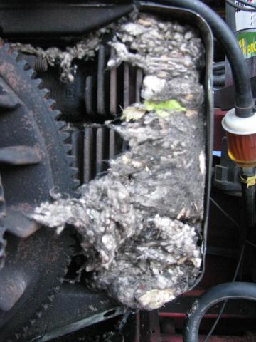

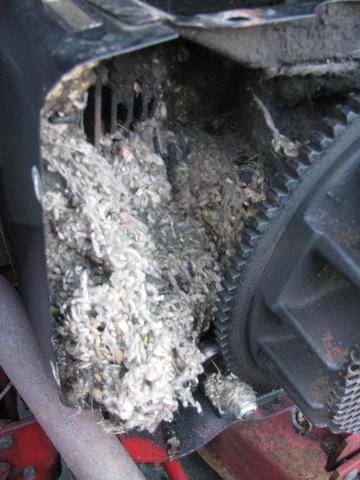

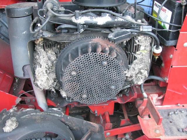

AMC RULES 37,260 #1 Posted December 28, 2013 When buying a tractor, and the owner says it's been in storage for a long time... do yourself a favor and pull the tins, you may be surprised what you find lurking in there. 5 Share this post Link to post Share on other sites
rmaynard 17,634 #2 Posted December 28, 2013 Looks like the mice had long term residency plans. 1 Share this post Link to post Share on other sites
chazm 413 #3 Posted December 28, 2013 Craig thats insulation for the little fellas... they don't need air conditioning this time of year... lol Chasm 1 Share this post Link to post Share on other sites
Sparky-(Admin) 26,625 #4 Posted December 28, 2013 Its good that you found it before overheating the motor and destroying it. Mike......... 1 Share this post Link to post Share on other sites
Martin 2,134 #5 Posted December 28, 2013 snap...... 2 Share this post Link to post Share on other sites
AMC RULES 37,260 #6 Posted December 28, 2013 I changed the oil when I first brought it home...then ran it up and down the street in front of the house. For as cold as it was outside, after shutting it down...the engine seemed a little too warm for my liking. Plus, while running, I kept seeing little specks of lint flying out of it...so I figured something was up. Little did I know, the mother of all mouse hotels was going on in there. Share this post Link to post Share on other sites

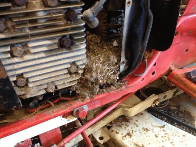

AMC RULES 37,260 #14 Posted December 29, 2013 So, I take it... these mouse hotels are a common occurrence? Share this post Link to post Share on other sites
Kennedy 151 #15 Posted December 30, 2013 I had a hotel constructed in the muffler of an old MTD I had. I didn't know it was there until a ball of flaming material come sailing out of the muffler. 2 Share this post Link to post Share on other sites
posifour11 723 #16 Posted December 30, 2013 I had a hotel constructed in the muffler of an old MTD I had. I didn't know it was there until a ball of flaming material come sailing out of the muffler. That happened to me with wasps ( I'm allergic) last summer. Had just bought it, PO could never get it running. Boy did I high step outta there fast! 1 Share this post Link to post Share on other sites
Kennedy 151 #17 Posted December 30, 2013 I should have know better. When I turned it over a live one bailed out. 2 Share this post Link to post Share on other sites
bigboy63 1 #18 Posted December 30, 2013 Hell I almost burnt down my neighbors 1920 wood floor garage . Learned my lesson 1 Share this post Link to post Share on other sites
brandonozz 168 #19 Posted December 30, 2013 I should have know better. When I turned it over a live one bailed out. Same here with mud daubers except they were long gone but their mud wasn't. Thought it was just a weak battery at first and then found out the large dirt ball was there on the flywheel when the starter wouldn't turn the engine over. 1 Share this post Link to post Share on other sites
pacer 3,181 #20 Posted December 30, 2013 Heh! I guess we all got stories about critters getting in our equip and shops - one of mine is mice ate the wiring on my D-180! Spark plug wires must have been extra tasty there wasnt much left of them, and scattered through out was tastings of the wire harness. And like brandon, down here the dirt daubers are as much of a problem as mice. I bought a milling machine to rebuild and on removing the motor to bench check it started up alright but was jumping all over the bench and making a terrible racket. On teardown there was NINE wads of mud scattered about! All total throughout the mill was some 30-40 wads. 1 Share this post Link to post Share on other sites
Lane Ranger 12,161 #21 Posted December 30, 2013 I think we had about two pounds of mice house insulation blown out of 12 horse Kohler motor on a C-160 that sat for seven years! Beats all I ever saw before! Must have been a condo arrangement! 1 Share this post Link to post Share on other sites
SousaKerry 503 #22 Posted December 30, 2013 Had a 12HP K301 that the mouse nest sat in the bottom of the shroud that it rusted right through from mouse pis and rain water. Rebuilt a Wisconsin V4 had nearly the same problem only not as bad pitted but not through. 1 Share this post Link to post Share on other sites
