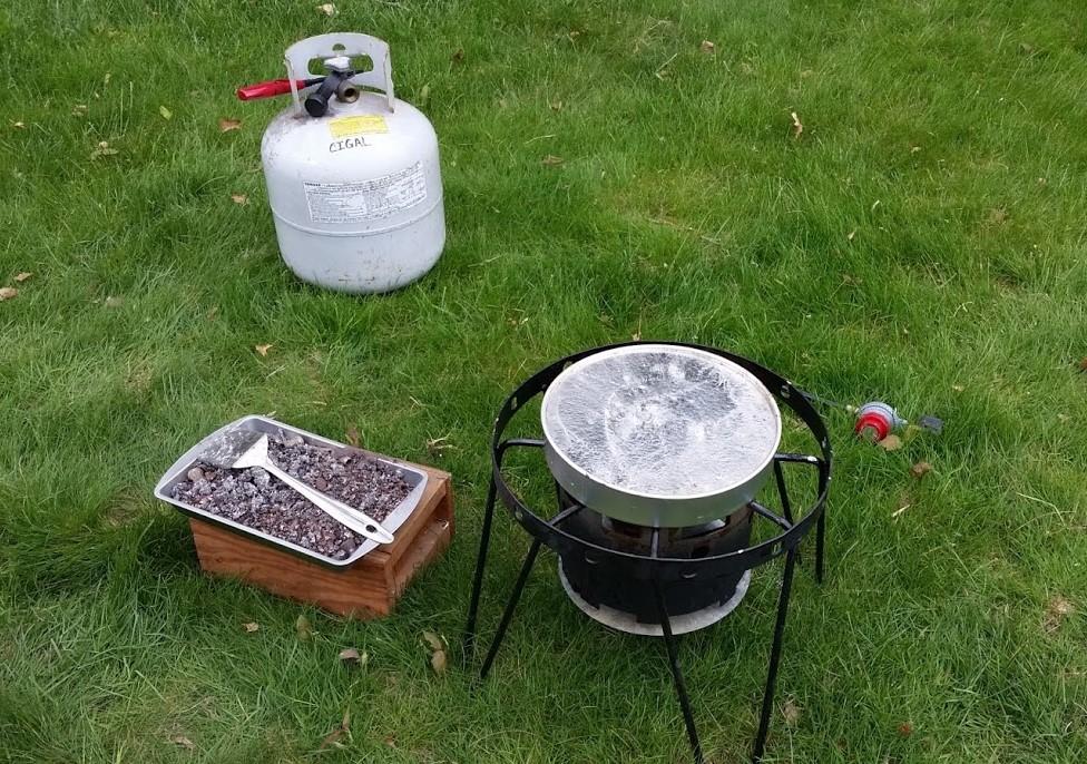

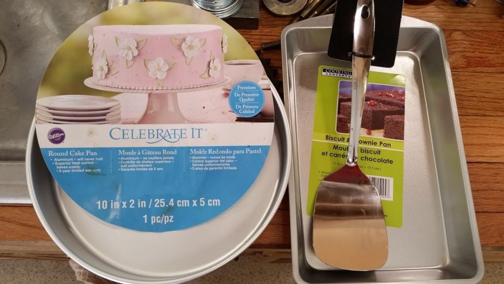

BPC23 18 #35 Posted January 29, 2020 (edited) I made my own wheel weights out of lead. Found a cake pan, 10" diameter x 2" tall, makes a disk that weighs nearly 50 lbs. Two of these fit inside the rear wheel, for nearly 100 lbs per wheel. I melted the lead in the cake pan over a turkey fryer. I wanted to leave the weights installed in the wheels on a permanent basis, yet be able to remove the wheels from the tractor in the summer. I drilled holes through the lead disks for the lug nuts and mounting bolts. Lead is really gummy; gotta keep the drill bit well lubricated. Add chains to the rear tires and it's a great combination. No need for front wheel weights; the snowblower is heavy enough. Use the lift assist spring, which transfers much of the snowblowers weight to the front tires when in the lowered position. I've got plans to cast lead weights that mount on the backside of the rear wheels. Edited January 30, 2020 by BPC23 Added pictures. Share this post Link to post Share on other sites
oliver2-44 11,825 #36 Posted January 29, 2020 6 minutes ago, BPC23 said: I made my own wheel weights out of lead. Found a cake pan, 9" diameter x 2" tall, makes a disk that weighs nearly 50 lbs. Two of these fit inside the rear wheel, for nearly 100 lbs. I melted the lead in the cake pan over a turkey fryer. I drilled holes through the lead disks for the lug nuts and mounting bolts. Lead is really gummy; gotta keep the drill bit well lubricated. Add chains to the rear tires and it's a great combination. No need for front wheel weights; the snowblower is heavy enough. Use the lift assist spring, which transfers much of the snowblowers weight to the front tires when in the lowered position. I've got plans to cast lead weights that mount on the backside of the rear wheels. @BPC23 I sure would like to see some pictures of those "cake pan" weights. Were you able to melt the lead in an thin aluminum cake pan? Years ago I made some weights for our boat when my son was just getting into wake boarding. I melted several batches of lead in a cast aluminum pot, and about the forth batch the bottom of the aluminum pot began to sag/melt. Share this post Link to post Share on other sites
BPC23 18 #37 Posted January 29, 2020 I believe it was an aluminum cake pan. Yes, it was thin. I used a couple pieces of sheet metal strategically placed under the cake pan to help support it on the turkey fryer stand. I made four disks and it's still usable, but I think it's feeling a little worn out. I'll take a couple pics tomorrow and post 'em here. Share this post Link to post Share on other sites

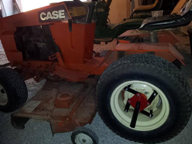

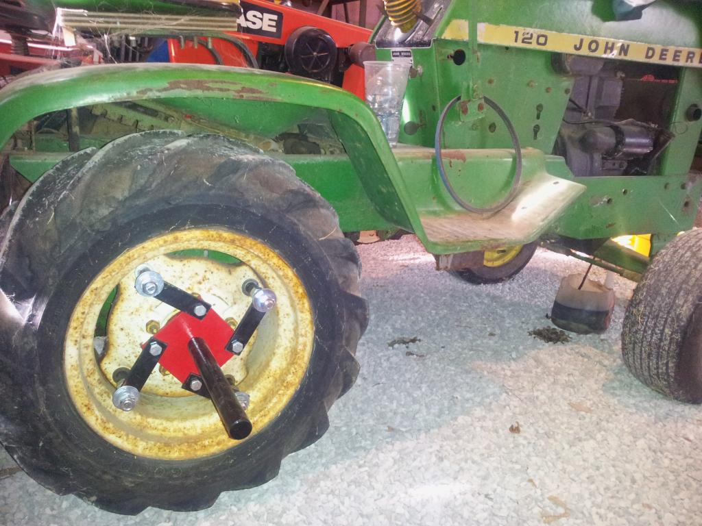

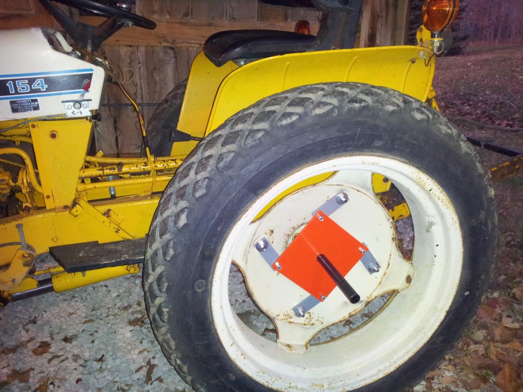

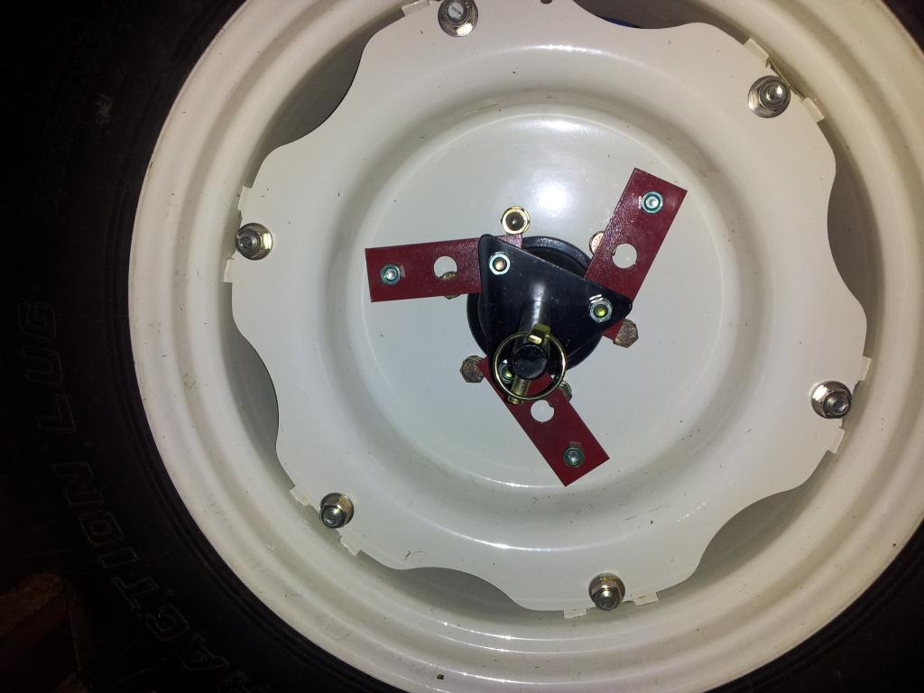

mgrubb47122 4 #39 Posted January 29, 2020 I created this setup to mount barbell weights on my rear wheels as well. Used to have a website called Lugghandles - more of a hobby than a business. These are easy to make if you have a good drill, a welder, and a steel band saw or a good hack saw and some patience. It adjusts to adapt whatever your wheel mounting holes are to the center plate with the 1" rod that the weight(s) are mounted over. 3 1 Share this post Link to post Share on other sites
WVHillbilly520H 10,379 #40 Posted January 29, 2020 3 hours ago, mgrubb47122 said: I created this setup to mount barbell weights on my rear wheels as well. Used to have a website called Lugghandles - more of a hobby than a business. These are easy to make if you have a good drill, a welder, and a steel band saw or a good hack saw and some patience. It adjusts to adapt whatever your wheel mounting holes are to the center plate with the 1" rod that the weight(s) are mounted over. Thanks, That could work on my 2 CUTs that have no weight holes drilled from the factory. Share this post Link to post Share on other sites
