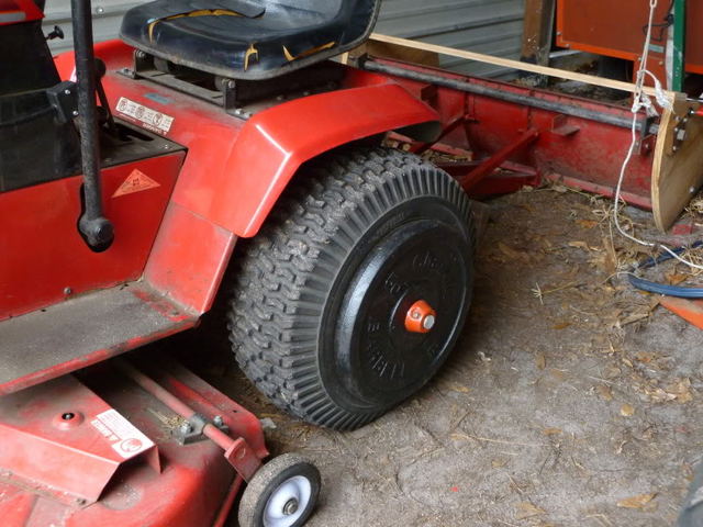

js5020 111 #3 Posted December 23, 2013 I'm currently running 50lb a wheel on the rears, nothing on the front at the moment. I use both the blower and blade depending on conditions. I prefer steel or cast weight of the barbell type myself no need to chase hard and spendy OEM weights. Barbell weights are easy to find and cheap, I got mine for free, just had to make the part to mount them. 1 Share this post Link to post Share on other sites

over60pirate 24 #8 Posted December 24, 2013 Behind the 50# barbell weights are 35#'s of smaller weights, for a total of 85#/wheel. They don't stick out far, and are real easy to install or remove. 1 Share this post Link to post Share on other sites
