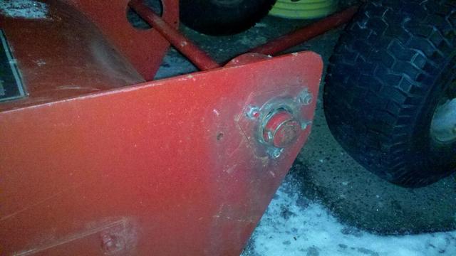

Scotsman 46 #1 Posted December 22, 2013 Due to working my 312-8 snowblower hard,I smoked a pulley right off. the bearing is still on, but the pulley came off. By the way my nephew left a foot long plastic toy truck in the driveway. It didn't even slow down the blower! Just made a sound......well a sound like a toy truck going through a snowblower! 1 Share this post Link to post Share on other sites

gwest_ca-(File Mod) 12,357 #3 Posted December 23, 2013 Did you lose an idler pulley or the driven pulley on the shaft? 3/4" shaft or 7/8" shaft? Garry Share this post Link to post Share on other sites
Scotsman 46 #4 Posted December 23, 2013 I am not near it right now,but its almost an inch so it must be 7/8 It was the one with the L shaped bracket to keep the belt on. Share this post Link to post Share on other sites
gwest_ca-(File Mod) 12,357 #5 Posted December 23, 2013 Believe this was the first model to use a 7/8" shaft The 7/8" shaft is item 28. Item 5 is the V-idler #7451. This is the same as the tractor clutch idler pulley. Napa HD 7-05485 is a replacement with a real ball bearing in it. Which part failed? Garry 1 Share this post Link to post Share on other sites
Scotsman 46 #6 Posted December 23, 2013 (edited) Wow Garry thank you so much! The bearing case stayed bolted on and the pulley came off cleanly like I pressed it out! Are the napa ones beefy like my old one? As they say"they don't build em like they used too" Edited December 23, 2013 by Scotsman Share this post Link to post Share on other sites
gwest_ca-(File Mod) 12,357 #7 Posted December 23, 2013 Napa has a regular idler with bicycle bearings but the HD Napa one has a 6203 bearing I believe that is bushed down to 3/8" for the bolt. I like them and usually this style is riveted together. I have drilled the rivets and replaced the bearing because I keep spare bearings but not spare idlers. Garry Share this post Link to post Share on other sites
Scotsman 46 #8 Posted December 23, 2013 (edited) Well the good part is I don't have to press out the old bearings, I can just press the new ones ib. I only have a vise so I am in luck. Thanks Garry Edited December 23, 2013 by Scotsman Share this post Link to post Share on other sites

Scotsman 46 #10 Posted December 23, 2013 Ordered it from napa 20$ Thanks Garry Share this post Link to post Share on other sites
