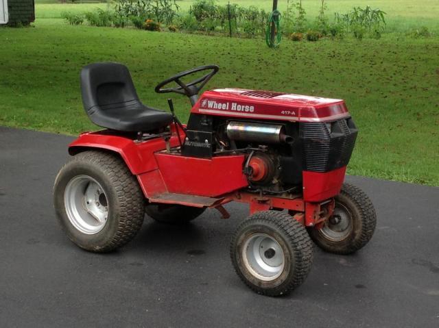

papaglide 542 #1 Posted December 22, 2013 For lack of a better term, i think that the internal governor in my KT17 II is broken. The only way to control the engines rpm's is by adjusting the throttle. Now for a couple of questions: -is there any easy fix? -are there any issues running the tractor this way, provided that I don't over rev the motor? Share this post Link to post Share on other sites

520HC 209 #5 Posted December 22, 2013 It could be just out of adjustment. Check with a engine manual to see. Share this post Link to post Share on other sites
papaglide 542 #6 Posted December 22, 2013 The tractor was just returned to me a short while back from an ex WH dealer who repaired a different problem. The mechanic was the one that suspected that that was the problem. He said that it was ok to run it as is. I was just asking the group if there were any alternatives other than taking the engine apart to fix it. Share this post Link to post Share on other sites
shorts 182 #7 Posted December 23, 2013 You probably should take it apart and fix it, if something internal is broke it is probably laying loose inside the engine and if it gets up into the rotating parts serious damage can occur Share this post Link to post Share on other sites
Pickle 43 #8 Posted December 23, 2013 (edited) You have a nice 1986 417A - well worth the governor repair cost. The discoloration of your muffler leads me to believe you are either running the engine too lean on fuel or have experienced over revs at some point in it's life. Edited December 23, 2013 by Pickle Share this post Link to post Share on other sites

Fordiesel69 276 #10 Posted December 23, 2013 Operating the engine yourself at the proper revs is not the problem, it is the loose parts that are going to destroy the engine. I ran a K181 8HP this way and it broke the dipper off the connecting rod. I was very thankful it did not harm the camshaft. If you don;t plan on rebuilding, you are only out the gaskets and the gov gear + a few beers. Share this post Link to post Share on other sites
papaglide 542 #11 Posted December 24, 2013 You guys are right. Not what I wanted to hear but.....I probably should get it repaired and not settle for running it the way that it is. As far as the muffler. It was rusty and I heard about an old rust cleaner; crumpled tin foil and coca cola. It sure did clean the rust but. Share this post Link to post Share on other sites
