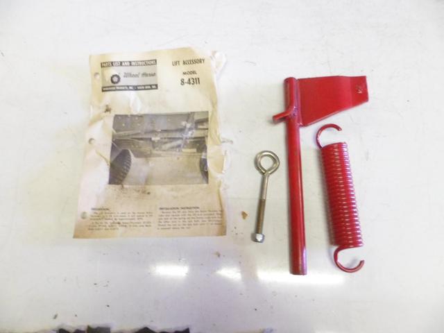

tmix 34 #6 Posted December 23, 2013 would someone have a pic of this lift assist spring? WOW my arm is tired Share this post Link to post Share on other sites
TT-(Moderator) 1,173 #7 Posted December 23, 2013 The lift assist spring is used with the snowthrower and attaches between a tab on the "flag" and the footrest mounting bar. I'm sure you could add a custom assist spring somewhere, but it can't be too strong or it won't allow the blade to ride firmly on the ground. The electric lift pictured above is for the newer models and won't work on pre-'78 tractors. There was a discussion on the forum a few years ago about adding the lift cylinder and control valve from a same-generation hydro tractor and powering it with an automotive power steering pump driven off the PTO. Another option would be to use an electric over hydraulic pump like those used on motorhome leveling jacks or convertible tops. Share this post Link to post Share on other sites
shorts 182 #8 Posted December 23, 2013 (edited) Vendor Glen Petit sells the lift springs for tillers and snowblowers, check his site Edited December 23, 2013 by shorts 1 Share this post Link to post Share on other sites

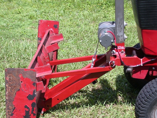

jimt1971 239 #9 Posted December 23, 2013 Electric winch hung off the front attachmatic works great. Share this post Link to post Share on other sites
dodgemike 52 #10 Posted December 23, 2013 I have pictures posted in the Dozers and blower section. I did This about 5 years ago. Small ATV Winch and simple bracket. Made It a lot more fun to plow snow! Sent from my SCH-S720C using Tapatalk 2 Share this post Link to post Share on other sites

Kelly 1,038 #17 Posted December 27, 2013 Craig, that is for the blower, the spring will work on a tiller, but they never made one for a plow, as was said above it would have to be a light duty spring almost not worth having Share this post Link to post Share on other sites

over60pirate 24 #19 Posted December 30, 2013 The winch and mount I made, can be used with a rear axle mounted plow also. I made this plow mount, because I didn't want to remove the mower deck, just to use the plow. I also made a plywood bucket bottom, for this plow. 2 pins pulled and the winch can be mounted in the rear, for implement lift. Pull 1 pin, and the mount tilts forward to allow the hood to be opened. After the picture was taken, I added power disconnect plugs to the front and rear of the tractor. 4 Share this post Link to post Share on other sites
posifour11 723 #20 Posted January 2, 2014 That's pretty darn neat! I like that! The winch and mount I made, can be used with a rear axle mounted plow also. I made this plow mount, because I didn't want to remove the mower deck, just to use the plow. I also made a plywood bucket bottom, for this plow. 2 pins pulled and the winch can be mounted in the rear, for implement lift. Pull 1 pin, and the mount tilts forward to allow the hood to be opened. After the picture was taken, I added power disconnect plugs to the front and rear of the tractor. 1 Share this post Link to post Share on other sites
