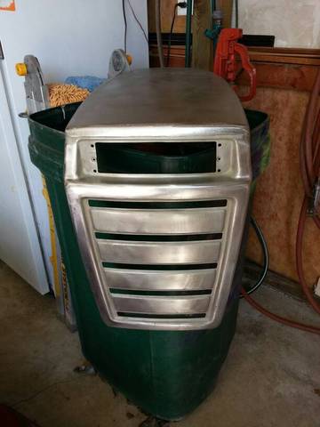

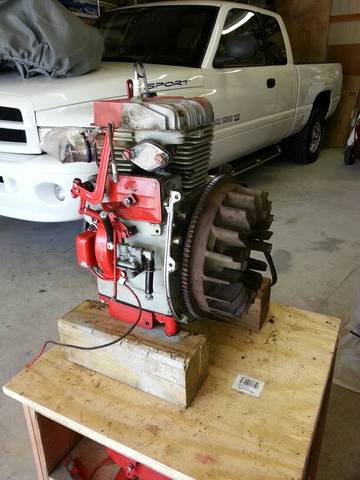

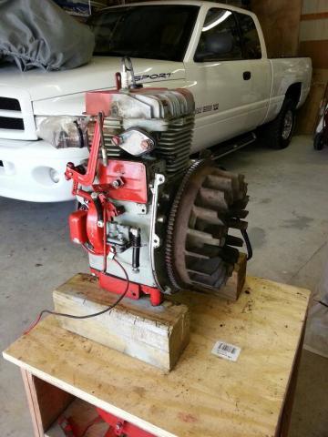

redrooster 83 #79 Posted April 14, 2014 Motor tins blasted. I had to braze the cracks where the coil mount always breaks. Im adding a backer plate on the inside of the cover to keep this from happening again. Share this post Link to post Share on other sites
redrooster 83 #80 Posted April 14, 2014 Motor cover. Share this post Link to post Share on other sites

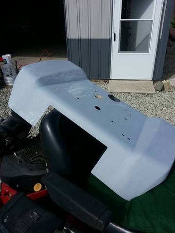

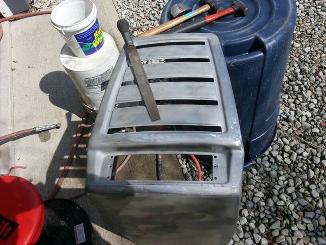

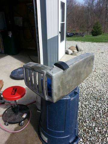

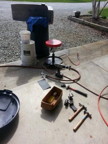

redrooster 83 #88 Posted April 18, 2014 Its taking a lot more time to do the fender and hood than thought because they got some abuse. Blast sand prime sand prime sand prime pound out dents file it takes time to do a good job! 1 Share this post Link to post Share on other sites

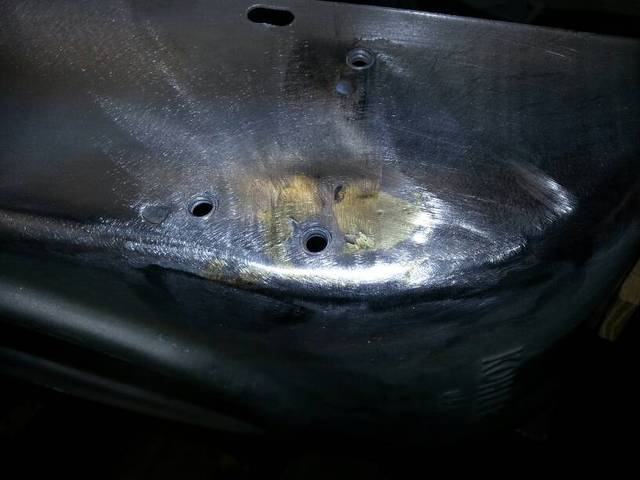

redrooster 83 #90 Posted April 19, 2014 Pounded out 5 dents and used the DA sander to remove some deep scratches and pitting. Also started cleaning the motor. 1 Share this post Link to post Share on other sites

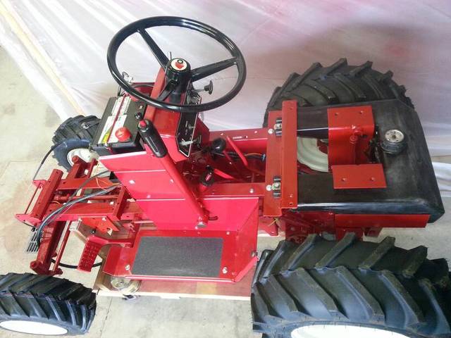

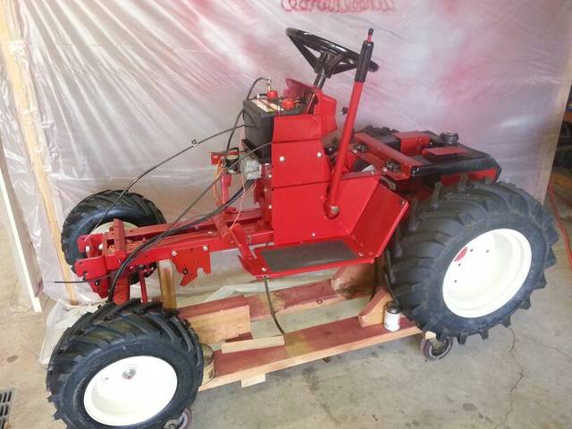

redrooster 83 #97 Posted May 6, 2014 Progress has been slow lately with the arrival of spring and yard chores. Had to start over on fender and hood because of a primer issue. I should be painting the motor soon. Put on new knobs, steering cap and anti-slip pads. 2 Share this post Link to post Share on other sites
