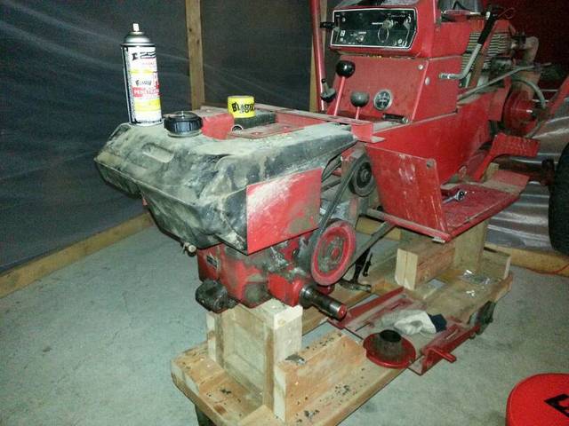

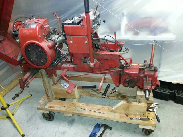

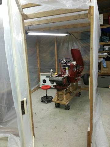

redrooster 83 #1 Posted December 21, 2013 Ok now the gravity of the beginning of the resto is starting to hit me. I have a few questions of how to go about it. before I reinvent the wheel I would like to get some direction on the best way to go about a resto. I have been collecting the parts and pieces that need replaced or repaired. I have built a dolly to move it around on and a temporary paint booth to contain the overspray and limit dust. 1. Should I completely disassemble it or attack in sections? 2.Should I sand blast as many parts as possible, wet sand, wire brush or a combo of all? 3.I plan on using enamel and I am wondering if I should primer (gray or red) every thing before painting or just paint those things that have a fair amount of factory paint on them and just primer things like the sheet metal? Share this post Link to post Share on other sites

neil 2,416 #5 Posted December 22, 2013 Its always a good start if you manage to get the steering wheel off in one piece . Is it a complete restoration that you want to do or do you just want a freshen up ? Share this post Link to post Share on other sites
redrooster 83 #6 Posted December 22, 2013 I was thinking a freshen up initially but now I'm thinking a complete restoration. Share this post Link to post Share on other sites
doc724 927 #7 Posted December 22, 2013 I just finished the restoration on my 78 C141-8 (except for the wheels). I took everything completely apart. The frame was the only part I had sandblasted. For all the other parts I used a combination of wire wheel, sanding with a micro motion sander, or hand sanding. For the really rusty parts I immersed them in vinegar for 48 hours. It took off the rust and any poorly adhering paint with a little help from running water and a wire brush. I don't have the skills to spray paint with a real sprayer, so I used rattle cans, brown primer first followed by a finish coat (Rustoleum Regal Red) . Each part was individually painted before reassembly. I bought all new hardware. Three tips I can offer you 1. For each sub assembly put the hardware an parts in cardboard boxes or zip bags (and label the sub assembly). You can decide what is a sub assembly. It make reassembly so much easier 2. Take plenty of pictures to help with the reassembly. 3. Remember that the frame/steel is the electrical ground. Paint is an insulator. Use numerous internal star washers to make sure you have good grounds (or run a separate ground wire where needed) P.S. Be very careful removing the interlock switch for the PTO. (I ruined mine and they are crazy expensive-I bought a used one). To get the interlock switch out, drill out the two pop rivets which hold the metal actuator in place, then you can take off the nut which holds the switch in place. Share this post Link to post Share on other sites

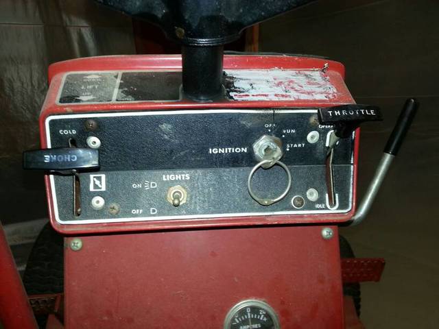

redrooster 83 #11 Posted January 1, 2014 Looking for suggestions on redoing the lettering on the choke and throttle knobs. Sent from my SPH-L710 using Tapatalk The adjustable wrench worked well to straighten out the dented rims. Thanks for the tip! Sent from my SPH-L710 using Tapatalk Sent from my SPH-L710 using Tapatalk Share this post Link to post Share on other sites
AMC RULES 37,260 #12 Posted January 1, 2014 New knobs here... Share this post Link to post Share on other sites
posifour11 723 #13 Posted January 1, 2014 (edited) Check out Glen's section under the vendor heading. He has them. Craig beat me to it. Edited January 1, 2014 by posifour11 Share this post Link to post Share on other sites

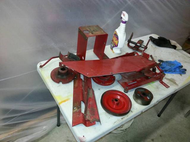

redrooster 83 #14 Posted January 6, 2014 I was looking at the lever and linkage that engage the mower clutch. Other than just wire brushing those items what would be a way to bring those back to the factory look? Share this post Link to post Share on other sites
AMC RULES 37,260 #15 Posted January 6, 2014 Electrolysis bath...is one way. Share this post Link to post Share on other sites
redrooster 83 #16 Posted January 7, 2014 Does anybody have them replated. Share this post Link to post Share on other sites
doc724 927 #17 Posted January 7, 2014 I repainted mine with grey paint. It looks fine. I am sure you can find someone local to clear zinc chromate plate them, but they would have to be rack plated-costly. Paint is way cheaper and just as effective Share this post Link to post Share on other sites
redrooster 83 #18 Posted January 7, 2014 Maybe I could go with rustolem silver. Share this post Link to post Share on other sites
