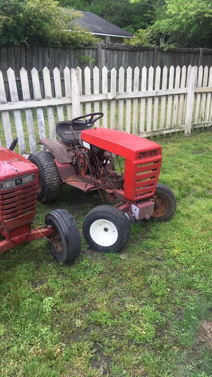

Darkitec 4 #6 Posted April 29, 2018 (edited) I've been hunting as well. I was able to find high speed trailer tires that are almost the same size as the originals. and they look like they will fit on the rim better than any of the 6.50 tires https://www.northerntool.com/shop/tools/product_200330364_200330364 It's going to be a little while before I can buy them, but I'll probably give these a try before going the other rout. Summet has these but they are a little more expensive. https://www.summitracing.com/parts/crr-5190501 Edited April 29, 2018 by Darkitec Share this post Link to post Share on other sites
Horse Play 393 #7 Posted April 29, 2018 23 minutes ago, Darkitec said: I've been hunting as well. I was able to find high speed trailer tires that are almost the same size as the originals. and they look like they will fit on the rim better than any of the 6.50 tires https://www.northerntool.com/shop/tools/product_200330364_200330364 It's going to be a little while before I can buy them, but I'll probably give these a try before going the other rout. Summet has these but they are a little more expensive. https://www.summitracing.com/parts/crr-5190501 Those will be too narrow of a tire for the wider wheels on tractors that originally had 5.50 wide tires. Share this post Link to post Share on other sites

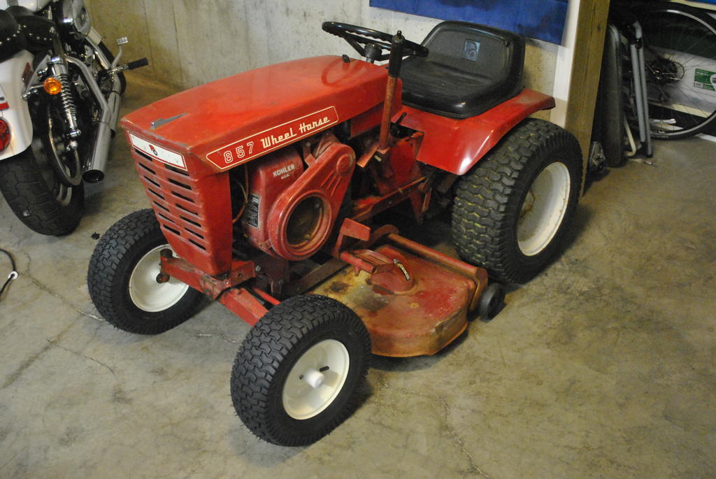

Horse Play 393 #8 Posted April 29, 2018 My 857 had the original 16x5.50-8 sawtooths. I searched all over for a 16x6.50-8 sawtooth; they doesn't exist. So I ended up using 16x6.50-8 Carlisle Turf Savers. Share this post Link to post Share on other sites

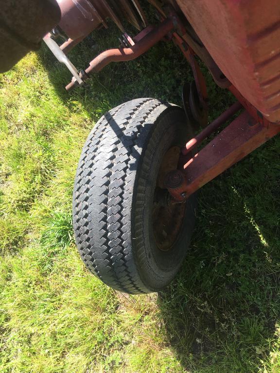

Darkitec 4 #9 Posted April 29, 2018 (edited) My original rims are only 3.75 to 4" wide between the beads, vs. the newer one that is 6.5" between beads. Yours looks like it's wider Edited April 29, 2018 by Darkitec 1 Share this post Link to post Share on other sites
Darkitec 4 #10 Posted April 29, 2018 Hard to tell from these photos but the bead is 1.25" back from the outside face of the tire. 1 Share this post Link to post Share on other sites
