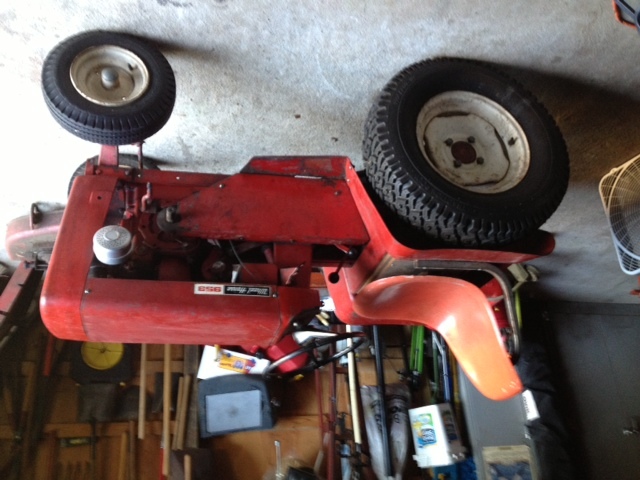

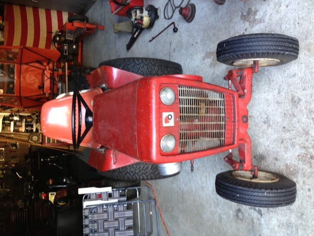

JERSEYHAWG / Glenn 4,590 #10 Posted December 18, 2013 Gentleman. The pics. Does she look like she is worth $300. ? Ooooooooops. Sorry. Not 100 percent on the pictures yet. Share this post Link to post Share on other sites
posifour11 723 #11 Posted December 18, 2013 Why isn't it in your garage? Share this post Link to post Share on other sites
stevasaurus 23,856 #12 Posted December 18, 2013 I would say yes...if the engine is good. Good tires, sheet metal, guards. $300 is the high end, but it is a good horse and looks like it is in very good shape. Share this post Link to post Share on other sites
953 nut 69,368 #13 Posted December 18, 2013 Get it! Hard to find one any better at twice the price. Share this post Link to post Share on other sites
sorekiwi 761 #14 Posted December 19, 2013 I'd pay $300 for that one in a heartbeat (even with the broken trans). 1 Share this post Link to post Share on other sites
evanloock 266 #15 Posted December 19, 2013 Judging by the steering wheel, an early 953 with the Ross steering assy. Share this post Link to post Share on other sites

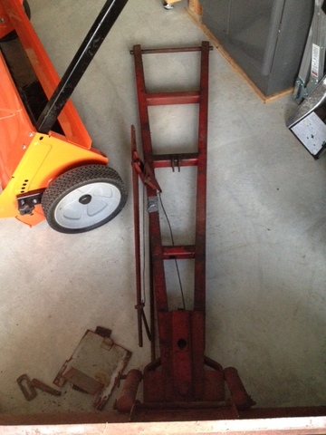

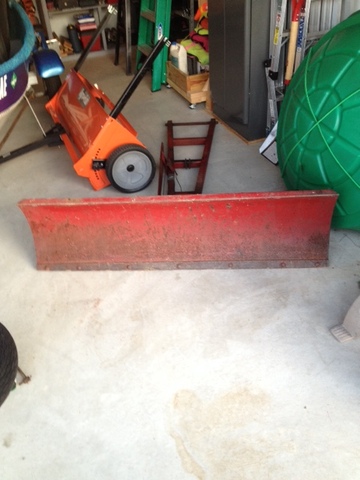

JERSEYHAWG / Glenn 4,590 #18 Posted December 24, 2013 Pics he sent also of the plow for it. Glenn Share this post Link to post Share on other sites
