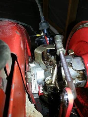

redrooster 83 #14 Posted March 25, 2014 Had the throttle shaft repaired by Brian Miller (long story) now working on linkage in pic Share this post Link to post Share on other sites
