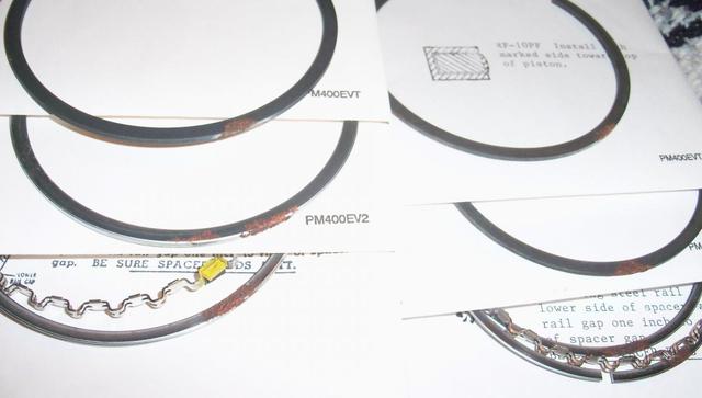

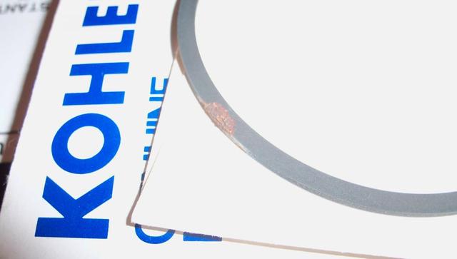

Pickle 43 #12 Posted December 23, 2013 See what you all think about the Ebay junk NOS Kohler rings I received for my KT17 II 417A. Share this post Link to post Share on other sites
JackC 619 #13 Posted December 23, 2013 Is that rust? If it is I assume it can be removed? Share this post Link to post Share on other sites
Pickle 43 #14 Posted December 23, 2013 (edited) Is that rust? If it is I assume it can be removed? Yes it is rust and no it cannot be removed - several layers of rusted flakes, rings have become pitted - I will not use them in my engine rebuild. Edited December 23, 2013 by Pickle Share this post Link to post Share on other sites
shorts 182 #15 Posted December 23, 2013 If you don't have the proper tools and ability to use them (micrometers) take the engine to a reputable machine shop and have them measure the engine and make a recommendation for an overhaul plan including machine work and parts. they will probably not use OEM Kohler parts, but Kohler didn't make their own pistons and rings,, they bought them from a tier 1 supplier in bulk and had repair parts kits packaged in their logo packaging for the retail market. 1 Share this post Link to post Share on other sites
Pickle 43 #16 Posted December 23, 2013 If you don't have the proper tools and ability to use them (micrometers) take the engine to a reputable machine shop and have them measure the engine and make a recommendation for an overhaul plan including machine work and parts. they will probably not use OEM Kohler parts, but Kohler didn't make their own pistons and rings,, they bought them from a tier 1 supplier in bulk and had repair parts kits packaged in their logo packaging for the retail market. Mechanic/machinist/degreed engineer with 35 years of engine experience and tools to complete the job. 1 Share this post Link to post Share on other sites
JackC 619 #17 Posted December 23, 2013 They must have been sitting on the shelf for a long time. I would send them back to the seller and ask them to send replacements but inspect them first. No doubt it is getting harder to find good parts. If you buy from someone else, also have them inspect before sending. Have you tried Small Engine parts Warehouse 1-800-236-2333? 1 Share this post Link to post Share on other sites
Pickle 43 #18 Posted December 23, 2013 I purchased two more sets of rings(replacement) from Pats Small Engine. Share this post Link to post Share on other sites
Wheel-N-It 2,978 #19 Posted December 26, 2013 Good thread guys. I've been wondering what to do when the series 2 on my 417A need rebuilding. Ken B's words give me some comfort though with his series 2 having just under 2000 hours. Mine has right at 890. It still runs great, and I have no complaints with it. Just thinking about the future. 1 Share this post Link to post Share on other sites
Fordiesel69 276 #20 Posted December 26, 2013 See what you all think about the Ebay junk NOS Kohler rings I received for my KT17 II 417A. I have bought many NOS ring sets over the years that were quite old. What would cause rust in just those spots and not the whole ring? I have never seen this before. 1 Share this post Link to post Share on other sites
Pickle 43 #21 Posted December 26, 2013 I would imagine his roof has a leak. Share this post Link to post Share on other sites
