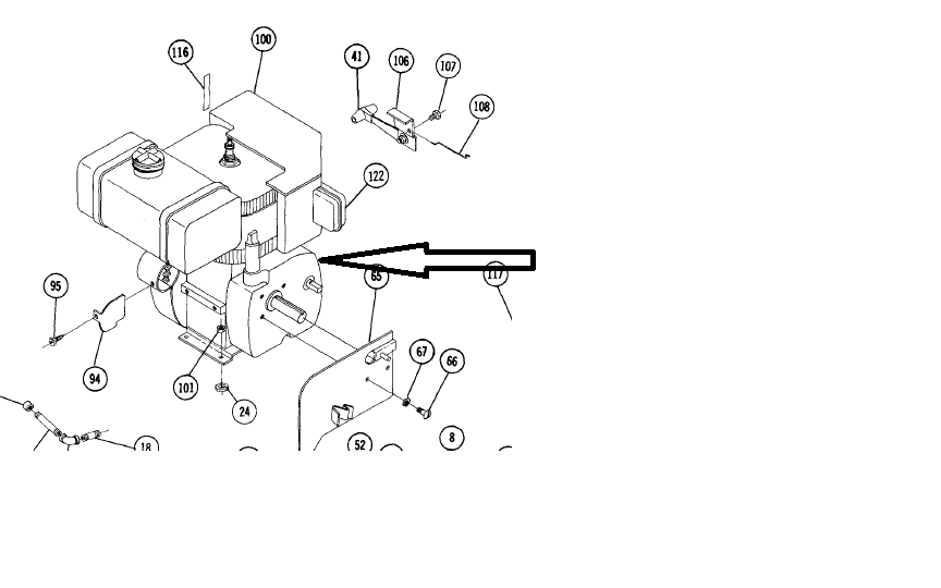

PBennison 0 #13 Posted January 5, 2014 (edited) OK, I have tried adjusting everything and the engine keeps running very rough. It is hard to start and takes a while to warm up and then under load almost dies. I think I "broke" something when I added too much oil and it came frothing out the breather. Since then I have installed a new carburetor, cleaned the breather, new spark plug ran fuel additive, adjusted the governor so I guess I may just buy a new engine. Here is my dilemma. I can find a horizontal shaft engine but I am puzzled by the dual pulleys on the existing machine. Is there some way the piece shown below can be reused on a new engine? Sorry for my lack of knowledge but I love the snowblower and just want to get an engine that does not take me 15 minutes and a bunch of carb cleaner to start. Pat Edited January 5, 2014 by PBennison Share this post Link to post Share on other sites
pfrederi 17,171 #14 Posted January 5, 2014 I am not familiar with your snowblower but from the diagram it appears in addition to the crankshaft pulley you may have a second pulley mounted on the cam shaft. I have not seen that on a snowblower but I believe some roto tillers used such a design. I would guess you could swap the cam shaft and engine end plate from your current motor to another H70 that had only a crankshaft pulley. Share this post Link to post Share on other sites
illinilefttackle 399 #15 Posted January 5, 2014 This is the manual for your type of snowblower- The small pulley actually drives your forward motion-so it is a necessity-my advice would be to look for a used engine-Good Luck-Al Snowthrower_26in_Walk_behind_1970_4-2651.pdf Share this post Link to post Share on other sites
