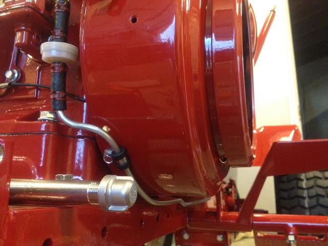

rmaynard 17,642 #4 Posted December 15, 2013 The only reason I use a sediment bowl is to keep my 701 all original. I found that the Briggs & Stratton bowl is a dead-on replacement for the original one from Wheel Horse. Having said that, I also put a mini filter inline between the bowl and the fuel pump. 2 Share this post Link to post Share on other sites
Martin 2,135 #5 Posted December 15, 2013 i did the same thing as bob on my 1057. i like the look of the sediment bowl on the bottom of the tank, but was also concerned about filtering...... i think its a briggs sediment bowl, i picked it up from napa. Share this post Link to post Share on other sites
