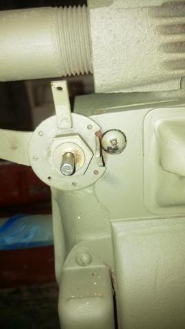

zanepetty 117 #1 Posted December 15, 2013 During my project I seem to have lost the linkage that goes from the carb to the governor arm. What is the best way of making one? Also what purpose does the price that goes behind the govenor shaft nut serve? Its not hooked to anything so I'm just wondering. Thanks Share this post Link to post Share on other sites

zanepetty 117 #3 Posted December 15, 2013 (edited) Yes I'm talking about the wire. I'd like to get one pretty soon if someone has one unless you think I should make one , Bob. As for the other peice, its longer and pointier. Goes behind that round price. Its the one sticking out to the side in the pictures. I'm just curious. Edited December 15, 2013 by zanepetty Share this post Link to post Share on other sites

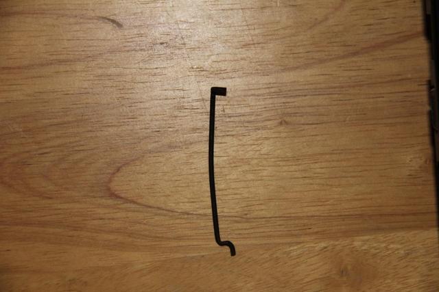

octfst 378 #4 Posted December 15, 2013 is this what you need. if so PM me your address & I will mail it to you. Share this post Link to post Share on other sites
zanepetty 117 #5 Posted December 15, 2013 Yes I think that's what I need. Is one end a tab or does it just look like that? Mine was just a price of wire. Share this post Link to post Share on other sites

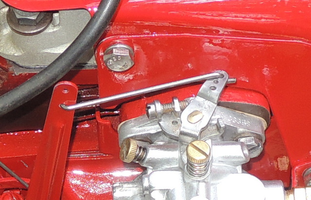

rmaynard 17,642 #6 Posted December 15, 2013 Should look like this, with a Z-bend at each end. Share this post Link to post Share on other sites
zanepetty 117 #7 Posted December 15, 2013 Yep sire does. The one in the pic just look a little different but I'm guessing it was just a weird pic. That carb looks amazing by the way Bob. Is your linkage stainless ? Share this post Link to post Share on other sites
rmaynard 17,642 #8 Posted December 15, 2013 No, it is zinc plated steel. The carburetor was cleaned, then polished with a 6" soft steel wire brush on my bench grinder. The hard-to-get-to spots were finished with a small wire brush on my Dremel. Share this post Link to post Share on other sites
octfst 378 #9 Posted December 15, 2013 that's it. the top bend looks funny in pic. it comes up then bend to the right. Share this post Link to post Share on other sites
