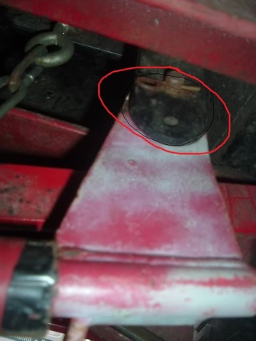

redidbull 54 #1 Posted December 14, 2013 I have search and still can not find any pics of how to mount the flag for the tractor to lift it.I thought it had to be on the lower arm but I am getting no lift. Please point me in the correct direction. Thanks. Jim Share this post Link to post Share on other sites

bubbacola 8 #4 Posted December 15, 2013 second hole lower arm... I have three snowthrowers two diffrent lengths lift shafts. You may have to add a few shaft colets between flag and shaft til you can lift your blower about three to four inches. took two colets on mine Share this post Link to post Share on other sites
Sparky-(Admin) 26,512 #5 Posted December 15, 2013 Second hole up from the bottom. Maybe your lift rod is to short, might need spacers like the guys have suggested. I think a pile of washers with a 3/4 hole is what works best. Mike........... Share this post Link to post Share on other sites
timo4352 148 #6 Posted December 15, 2013 Second hole up from the bottom. Blowerhookup009#2.jpg Maybe your lift rod is to short, might need spacers like the guys have suggested. I think a pile of washers with a 3/4 hole is what works best. Mike........... I guess that's why I had a hell of a time with mine - I went in the next or third hole up. That first hole is too small to fit the pin into, so I went up two holes from there into the third one. So I should have counted the undersize hole as one - correct? Share this post Link to post Share on other sites
cod 136 #7 Posted December 15, 2013 A couple of weeks back I asked a similar question and here's the link: as I was unable to get my snowthrower to lift evenly off the ground as the left side is barely 1/2 inch while the right side is about 1-1/2 inches. At the time I attached the the snowthrower I used the second hole just like what you see in Sparky's picture. Oddly enough today I found and downloaded this manual "Snowthrower 42inch 1984-87 06-42ST04 OM #810246R1" from the manuals section of this forum for my snowthrower. When I looked at the flag attachment section it looks to me as you need to use the top ( or third hole up from the bottom ) hole of the lift arm. So I went out finally managed to get the clip installed but it wasn't easy. Once the I had it all together, I fired the beast up and tried to lift the snowthrower but now it wouldn't lift at all, so I switched it back. It sounds like what I really need to do is add a bunch of washers to take up all of the slop between the flag and the tube it slides into to get the thrower higher off the ground and I might even be able the use the second hole to make it easier on both my eyes and numb fingers. Share this post Link to post Share on other sites

GlenPettit 1,719 #14 Posted December 19, 2013 (edited) ] The "Bellcrank" is the right-angle part with the holes in it, the longer lower portion is where the "Flag" goes (the upper part with the chain and the 'lift arm' are not used with the snowthrower). The strong Assist Spring helps with the lifting a lot, and it's tension can be adjusted with the eye-bolt (shown with max tension here). Washers/spacers are added where the Flag goes into the tube end. Install the Flag and Spring first, before sliding the tube onto it, (you can raise left side up for more clearance installing the flag then). Edited December 19, 2013 by GlenPettit Share this post Link to post Share on other sites
