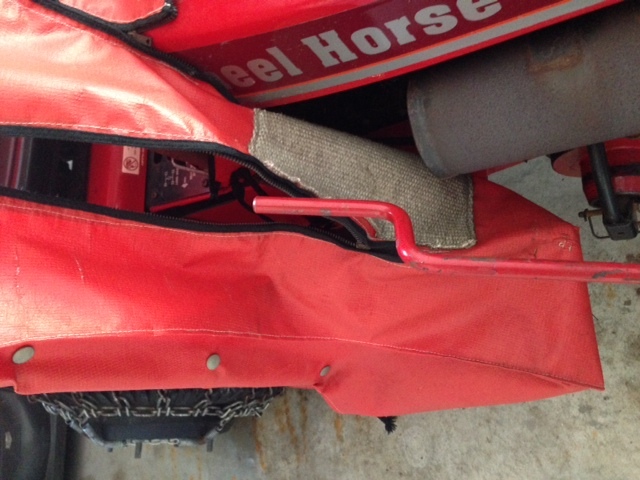

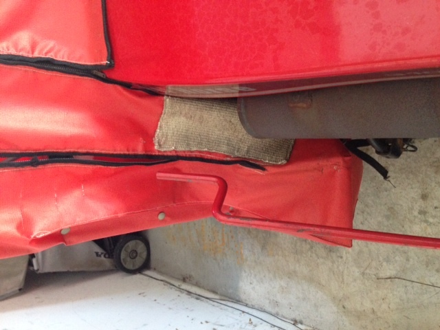

mbarb54 8 #5 Posted December 28, 2013 Thanks for the information about the chute control extension. The Original Cab company does not have this listed on their current parts list but I have emailed them and will post if they still have the part available. My cab is a P647CC, so I don't know if the chute extension part for the 79978 will work with my cab or not. I also sent them these pics to show my situation. If anyone has any other information or ideas, please post. Thanks Share this post Link to post Share on other sites
MalMac 1,328 #6 Posted December 30, 2013 If you have the older style short chute blower the crank system is totally different. What you need to do its cut the crank handle and get a sleeve extension that would connect the two pieces of crank. That's what essentially the extension kit does on the newer style. The crank has a whole drilled in it where the sleeve fits over it and has a hair pin in it to connect it to the lower handle and the same up on the upper. You will need to fab some sort of support in the cab for the crank to run through. Share this post Link to post Share on other sites
can whlvr 991 #7 Posted December 30, 2013 I made a home made for my homemade cab,i made the whole shaft longer and bent the crank hanle in it,got the rolled steel at my local steel wholesaler for about 15 bucks,my cab cross brace held it up or it wouldn't work very well asthey get wobbly that long with out some sort of brace Share this post Link to post Share on other sites
mbarb54 8 #8 Posted December 31, 2013 I checked with The Original Cab company about the extension part #9200. They confirmed that it will not work with the older style short chute blowers.That part was made for a different blower. The newer ones I guess. Too bad. . Share this post Link to post Share on other sites

MalMac 1,328 #10 Posted December 31, 2013 (edited) Like I said I think your only option is to make an entirely new handle or splice it. I am not sure but if you go with a whole new handle I think the angle will be too great and stick out too far to go in the cab. On the newer ones that is basically what they did they just added an extension to the handle from where it attachés to the blower. Which is nothing but a splice. The handle on the newer style is not a one piece like you have. It attachés to the blower with a hair pin. All they did was put a splice in between the blower and handle. Yours would be the same thing by cutting it and putting in a splice. If I remember right on my stage there was enough movement in the splice that I did not have to use a swivel. If I get time I will try and take a picture of the kit. I believe it will work for you if you would decide to splice it. Edited December 31, 2013 by MalMac Share this post Link to post Share on other sites
