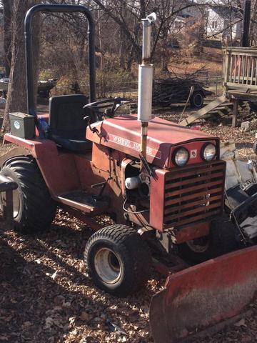

themasterofmachines 3 #6 Posted December 12, 2013 This is her. Share this post Link to post Share on other sites
