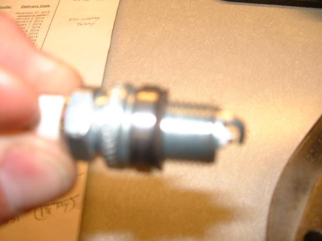

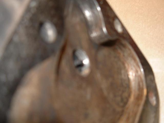

Coadster32 793 #1 Posted December 11, 2013 So I'm doing a "once over" on a tractor that I just recently got, 855. The PO had paid someone to go thru this tractor, and the more I do, the less I see he did, (ie: oil change, transaxle oil change, air filter, electrical connections broke, etc.) I had bought all the parts I needed from Pats (PSEP) a few weeks ago, and am now getting to doing the work. Normally never a problem getting the right stuff from there. I knew the carb needed a GOOD cleaning, as did the combustion chamber. Figure I'd do the carb and run seafoam thru once back together, would be my first try at using it. Anyhow, I pulled the shortie plug out, and realized the new plug was longer. Obviously one is wrong. Looks like the new plug would bottom out on the top of the block if put in all the way. It wouldn't screw in all the way anyhow, as the last few threads were messed up in the head. (I'm figuring due to possibly arking). Anyhow, decided to pull the head off, (good thing as tons of grass and crap would have overheated me eventually). I noticed the shortie plug didn't protrude into the chamber, as the head is thicker than the plug. I never had really thought of this before, as usually when I take the head off, the spark plug is out of the head already. I repaired the threads, tested my theory (plug bottoms out before head touches block), and proceeded to think. Why could/should the spark be in the threaded hole of the head, instead of the chamber itself? Perhaps extra plug fouling of the exhaust side? I think not as in the new head designs the plug was moved closer to/over the exhaust opening. Perhaps the gas from the intake soaking the plug? Maybe. What I did was make a spacer to be able to use the new plugs I had just purchase. It puts the electrode just into the chamber. It's an easy change if it doesn't work, but just wanted to throw this out there for some technical discussion. (Sorry the pictures kind of stink, and my camera battery crapped out.) Share this post Link to post Share on other sites

Coadster32 793 #5 Posted December 22, 2013 (edited) Kind of surprised nobody's really chiming in on this...especially the puller gents. Anyhow, I have three hours on this 855 tractor with the longer plug. It starts up pretty easy, and runs really good. I pulled the plug out of my 854, and of course it was a shorty..(rj8c). Both tractors are running well, so I'm just going to keep things the way they are. Still wondering though. The black lines represent the head width. The bottom plug is the stock plug recommended by Kohler. The depth in the head of this plug is shown in the first blurred picture in this thread. The top plug is the longer reach plug, with a washer I made up added to it. I switch the crush washer position with the washer I made so the crush washer goes against the head...(of course). Only the electrode sticks out of the head into the chamber. I know three hours isn't a lot of time, but thought it would have fouled out by now if this was the case...especially since I have been snow throwing with it. I had it idling for some time as well, just to see. Edited December 22, 2013 by Coadster32 1 Share this post Link to post Share on other sites
