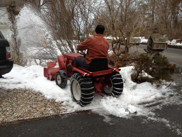

Machria 92 #1 Posted December 10, 2013 (edited) My GT14 has regular garden tires on it, with chains installed. Works fine in woods (hauling firewood out), and works fine in the snow snowblowing. BUT, it's bunpy and lumpy and makes noise when I'm on the street with the chains. I often have to go a 100 yards or so down the payvment to get to the woods.... and I'm sure that doesn't do the chains any good. So, would I be better off with an Agro type tire? Do agro's work ok in the snow, as good as chains? OR? Edited December 10, 2013 by Machria 2 Share this post Link to post Share on other sites

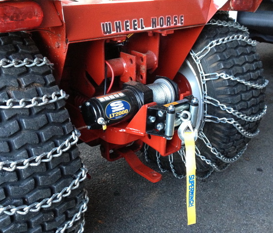

AMC RULES 37,260 #14 Posted December 13, 2013 I'm really digging that winch mount Machria. Share this post Link to post Share on other sites
Brrly1 1,146 #15 Posted December 13, 2013 The 15" ags for GT14 are hard to find unless you want to run skid steer tires(NOT)because they no longer make them. Wait I stand corrected they do make a 7.60 thats made by American Farmer carried by Miller Tire in Ohio. Thats about an 1" or so differance. Nobody makes the 8.50 anymore Share this post Link to post Share on other sites
Machria 92 #16 Posted December 14, 2013 I'm really digging that winch mount Machria. Scot on this site built that for me. I just had him customize the "custom 2" hitch" he makes. Here was the tread, check out post #78: Here is the latest build, you can order one.... . 1 Share this post Link to post Share on other sites
AMC RULES 37,260 #17 Posted December 14, 2013 Nice...did your roller fairlead come from Northern tool as well? Share this post Link to post Share on other sites
Machria 92 #18 Posted December 15, 2013 Yes, comes as part of the winch. Think I bought it on sale on Amazon for $75 Share this post Link to post Share on other sites
