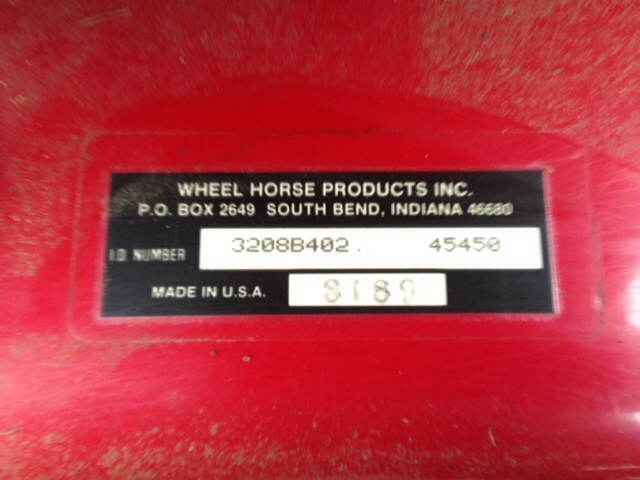

Mgbchuck 4 #3 Posted December 11, 2013 My new deck has an ID # 3208B402. 45450. Then 8189 on the bottom of the tag. Are there baggers available to buy for this 42" mower??? Chuck Share this post Link to post Share on other sites
nylyon-(Admin) 9,172 #4 Posted December 11, 2013 Are you certain on that model number? 32-08B402 is a 208-4 tractor? Share this post Link to post Share on other sites
Mgbchuck 4 #5 Posted December 12, 2013 Here is the tag on my mowing deck..... Just waned to know of I can adapt my old bagger from my old deck... Or is a chute available to fit this new deck. Thanks.... Chuck.... Akron Ohio Share this post Link to post Share on other sites

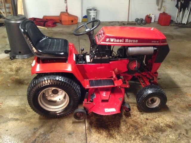

Mgbchuck 4 #7 Posted December 12, 2013 Howdy.........Here are two photos....my old WH with a Bagger.... 37' deck ...... and my new 312-8 Wh and 42" deck. Is it possible to get a different chute to work with these baggers on my new 312. I can get the bags on my new 312..... just was to see if they make just the plastic tube (chute) that goes to the bags.... Any thoughts???????????? Thanks... Chuck Lyons Akron, Ohio Share this post Link to post Share on other sites
gwest_ca-(File Mod) 12,533 #8 Posted December 12, 2013 I am quite sure the 42" deck required a vacuum blower to move the clippings. Just the 37" and smaller decks could do it on their own. Here are the parts lists for the 1988 37" decks on the 200-Series and the 300-Series Garry Share this post Link to post Share on other sites
