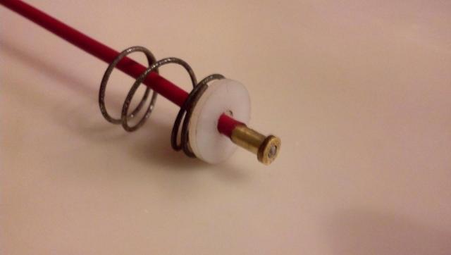

benjiboo 174 #1 Posted December 7, 2013 So I was missing the headlight contacts for my C-160 and bought some that were "sight un-seen" that turned out to be overpriced for being used and being junk. Bummer. So....., after seeing what they are supposed to look like I decided I would just machine the parts and make some new ones myself, for FREE. Lol. Now, I definately didn't "re-invent" the wheel here, but do feel I did recreate a "better built wheel" in my opinion. The stock parts didn't seem to have held up too well, so I used some better than stock materials to fab up my own. I used brass for the contacts and nylon for the insulator, both being turned from rod stock on the lathe. The brass contact is hollow and soldered to the wire and the insulator is essentially an odd sized nylon washer but none the less still had to be custom made. Anyway, thought you guys/gals might like to see what I came up with. 5 Share this post Link to post Share on other sites

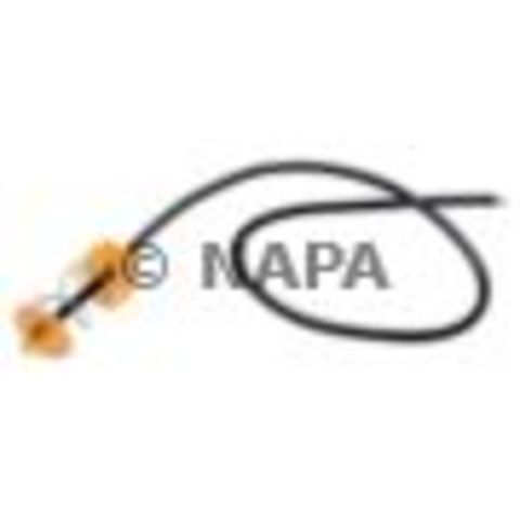

Trouty56 567 #6 Posted December 7, 2013 Can't beat that price.....or quality.....good job.... Napa sells a socket and spring/wire/insulator setup for these bulbs... I have bought sets and just used the wires and insulator but have also used the whole socket on occasion... Might be part # ECH LS6427....just looked on the website but I think I have a box for reference in the garage.....probably that one I just threw out though.... 1 Share this post Link to post Share on other sites

squonk 45,390 #9 Posted December 7, 2013 Napa # is LS6226 1 Share this post Link to post Share on other sites
Trouty56 567 #10 Posted December 8, 2013 Napa # is LS6226 Well...I didn't know about this product....I always got the whole light socket assembly.... Share this post Link to post Share on other sites

Hydro 131 #13 Posted December 29, 2013 Reminds me of a shell casing Mark. I wonder if there would be a calibre out there that would work? Share this post Link to post Share on other sites
