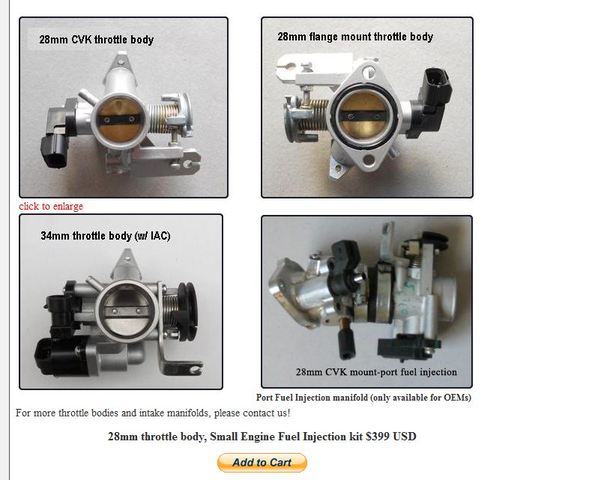

KATO 115 #4 Posted December 5, 2013 Check this :handgestures-thumbupright: http://www.ecotrons.com/products/small_engine_fuel_injection_kit-2/ Share this post Link to post Share on other sites
Coadster32 793 #5 Posted December 5, 2013 Check this :handgestures-thumbupright: http://www.ecotrons.com/products/small_engine_fuel_injection_kit-2/ Alright...who's gonna bite the bullet, and post this build?? Share this post Link to post Share on other sites
Fordiesel69 272 #6 Posted December 5, 2013 Any idea of the cost? Share this post Link to post Share on other sites
VinsRJ 723 #7 Posted December 5, 2013 Any idea of the cost? Thats what I was thnking also... Share this post Link to post Share on other sites
SousaKerry 503 #8 Posted December 5, 2013 Only $399. I'll wait... Share this post Link to post Share on other sites
Fordiesel69 272 #9 Posted December 5, 2013 If i had metal fab skills, I really would try it out. Fuel injection would really extend the life of these dirty beasts. Your cloths stink after plowing. With a newer engine this is much less. Share this post Link to post Share on other sites
