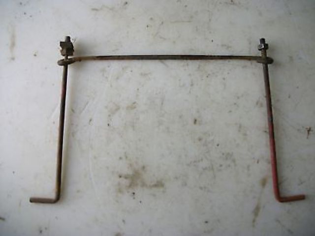

rmaynard 17,659 #6 Posted December 4, 2013 Most tractor batteries are designated U1. The U1's that I buy from Battery Warehouse are 8.25" long x 5-3/16" wide You could always get a set of clamps similar to the ones pictured below to hold it down. Share this post Link to post Share on other sites
