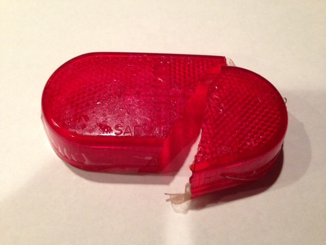

Mgbchuck 4 #1 Posted December 3, 2013 Howdy,,,,, I have been cleaning up my new WH The ID # under the seat is.... 2112K804. 2094 ... I believe that is what it says.... The numbers are worn. Not sure if that is a K Anyone help as to the year of this 312-8 . I need to order a new tail light and lamp.... The one on there is broken.... And the lamp is gone. The number on the tail light is PM 108 15. And. SAE AP2-79. Any suggestions online as to where to order this. Here is a photo of the lense...... Thanks....Chuck Lyons. Akron Ohio Share this post Link to post Share on other sites
meadowfield 2,955 #2 Posted December 3, 2013 That's a 1987 12hp, 8 speed, 312-8 the k stands for kohler. Share this post Link to post Share on other sites
rmaynard 17,113 #3 Posted December 3, 2013 Try connecting to this link to order your parts. http://www.smallenginepartswarehouse.com/p/toro-parts?aribrand=TO#/Toro_Consumer/21-12K804%2c_312-8_Garden_Tractor%2c_1987/ELECTRICAL_SYSTEM/21-12K804-1704-1987/810480R1-80R10048-00022 Share this post Link to post Share on other sites
squonk 46,189 #4 Posted December 3, 2013 Take that lens to Napa. Common lamp Share this post Link to post Share on other sites

bowtieguy 334 #11 Posted December 5, 2013 Like Mike said...it is a common lens....made right here in good ole Grandview, Miissouri, USA...(PM)= Peterson Mfg......unless they have "outsourced" by now! Share this post Link to post Share on other sites
