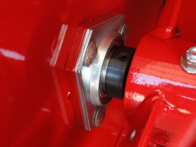

CTBT&D 77 #10 Posted December 8, 2013 I used self centering sealed ball bearings with a locking collar and flanges from TSC. Also made a 1/4" spacer as seen in the photo. Craig Share this post Link to post Share on other sites
