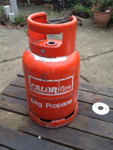

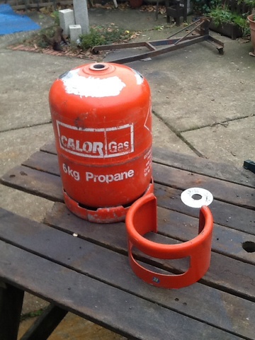

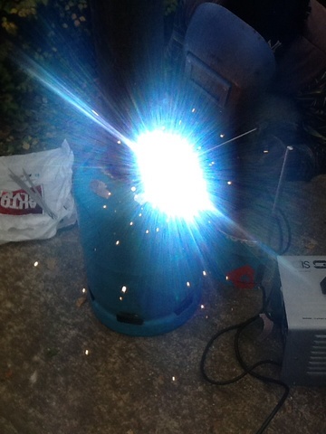

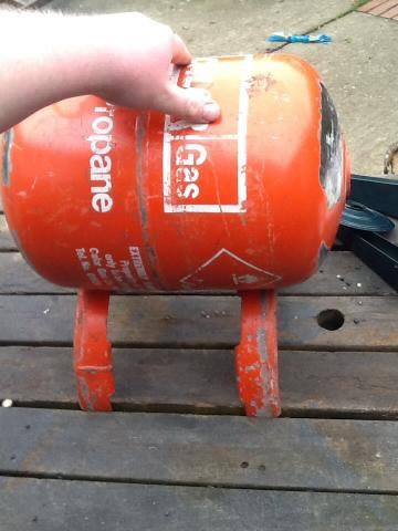

Charlie Smith 142 #1 Posted November 29, 2013 Hello All, For this winter I've been thinking if ways to keep warm outside,...... and boil the kettle then I remembered seeing something Ian had brought/made/adapted, I got in touch with him and he kindly shared some information and the link to his old thread about it, I'm making a up/recycle wood burner/heater from an old gas bottle, the one I'm making at the moment is a small little 6kg bottle, this is just to make and see how it goes, if it Is reasonably easy and works well I have a larger gas bottle waiting to be made, however here's the start of the small trial heater/burner, Share this post Link to post Share on other sites

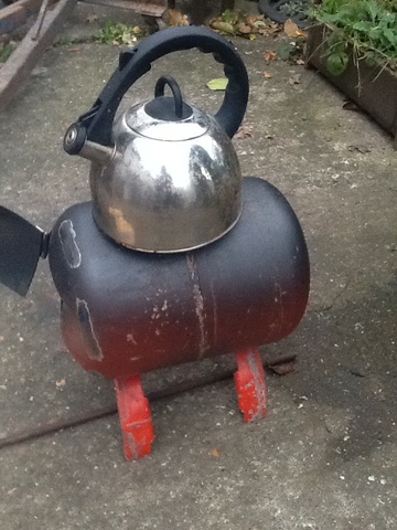

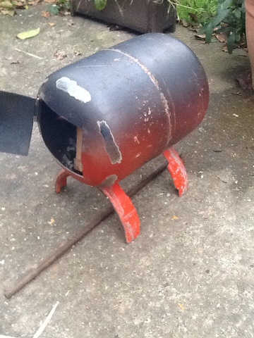

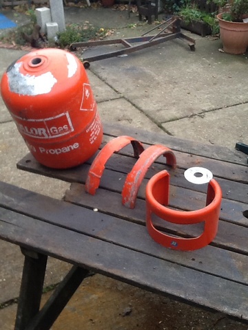

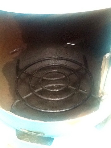

Charlie Smith 142 #6 Posted November 29, 2013 Hello all not bad for half a days work, So 1 day, 4 welding rods, 2 cutting discs later,...... We have this invention. It's not yet compleat as it wil need a chimney and some heat resistance paint, but I think it's doing pretty well, I'm pleased with the outcome so now I know it's easy enough to do, I shall start on the big gas bottel, Share this post Link to post Share on other sites

timo4352 147 #10 Posted November 29, 2013 Pretty cool. Weld a little flat plate to set your kettle on. Share this post Link to post Share on other sites
Charlie Smith 142 #11 Posted November 29, 2013 (edited) Yes, we must sort out a chimney and a flat plate for cooking/boiling kettles etc, However my main focus is on building a much bigger more robust one now Edited November 29, 2013 by Charlie Smith Share this post Link to post Share on other sites
neil 2,415 #12 Posted November 30, 2013 Charlie , great little project, you could use the little one for your camping stove or even a small bar b que Share this post Link to post Share on other sites
Stigian 1,234 #13 Posted November 30, 2013 Nice work Charlie, can't wait to see what the big one turns out like I'm with Neil, finish the little one and use it for camping. Share this post Link to post Share on other sites
Charlie Smith 142 #14 Posted November 30, 2013 Yes I agree, and when I start the big one I shall update you all with a lot more pictures then this one, I will take pictures each of the stages one by one, and yes, I am going to finish the little one off, get it looking really neat, and take it away with us, camping and to all the shows etc, Share this post Link to post Share on other sites

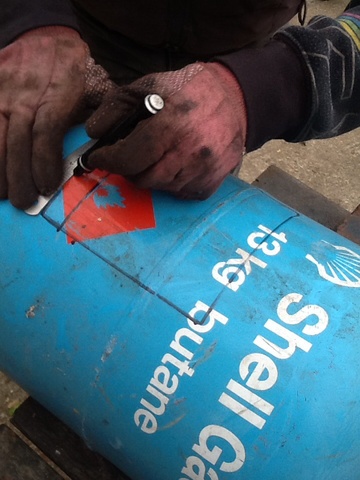

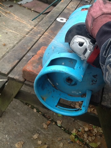

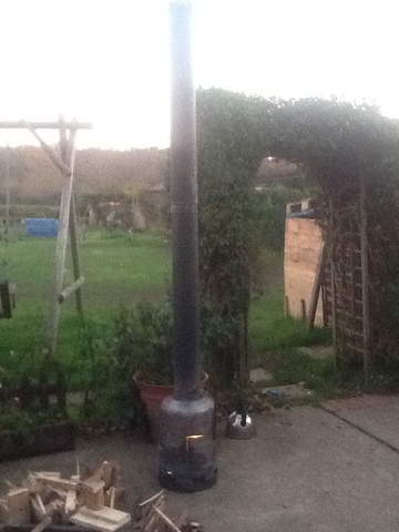

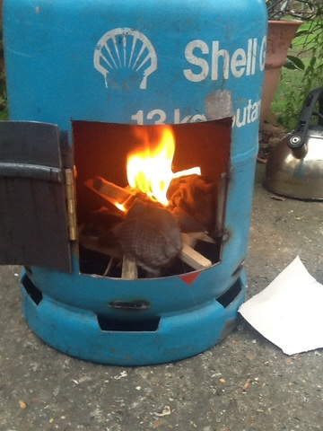

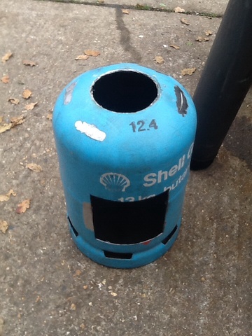

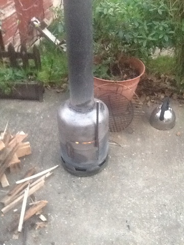

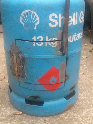

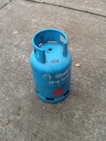

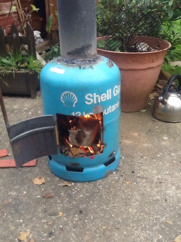

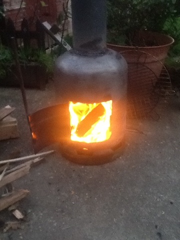

Charlie Smith 142 #15 Posted December 1, 2013 Hello all, The slightly bigger/better one is here now, currently as a patio heater, but will be installed into the shed ASAP, Now for the good bits, PICTURES! 3 Share this post Link to post Share on other sites
AMC RULES 37,250 #16 Posted December 1, 2013 WOW! Fast like a bunny you are... nice lookin' little heater you've made there. 1 Share this post Link to post Share on other sites
Charlie Smith 142 #17 Posted December 1, 2013 Well the weathers getting a little colder every day as we come closer to christmas, so I thought I best not hang about, and hurry and build too keep myself warm, must I say, I did have my little one going whilst making this one you'd be surprised of the heat they chuck out...... 1 Share this post Link to post Share on other sites

Stormin 9,986 #22 Posted December 3, 2013 Your second one Charlie, is the same as the one I've made. Only difference is mine is on three legs. Keeps the heat from the floor. And your dead right about the amount of heat they put out. Toasty! Share this post Link to post Share on other sites
