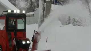

HorseFixer 2,015 #1 Posted November 29, 2013 (edited) Well got a real wet snow yesterday, So got MJ on the Camera. Here is the 520 Snow Chucker in Operation. ~Duke Edited November 29, 2013 by HorseFixer 5 Share this post Link to post Share on other sites

Digger 66 3,530 #7 Posted November 29, 2013 Looks like it'snot even working up a sweat . The chute deflector ? Homebrewed ? Pneumatic or hydro ? 1 Share this post Link to post Share on other sites
RMCIII 840 #8 Posted November 29, 2013 (edited) duke- nice video.. Question,,,, what is the gap between the scraper bar and concrete? By the way it appears, with very little snow left on your passes, the scraper bar does not even have a gap.. Also, what are all the extra lights running off of? Rob Edited November 29, 2013 by RMCIII 1 Share this post Link to post Share on other sites

HorseFixer 2,015 #10 Posted November 29, 2013 (edited) Thanks Folks! I've Started to make a Video to give a Step by Step of all the Work, Options and Modifications that I did to build this Contraption. There is Just too many things that are not seen. Digger, On the Chute Deflector I assume your talking on the Mechanical Operation...... It is designed and built by me, and is operated with Electric Motors / Actuator. RMCIII, Twice a year Usually Nov and end of Dec I check the gap and put it at 1/4" What I do is I have a Strip of 1/4" Nylon and lay it down side to side under scraper blade and then adjust the shoes. The lights are running off the Tractors Battery and Charging System being that All Lights are LED the amperage usage is amazingly low. ~Duke Edited November 29, 2013 by HorseFixer Share this post Link to post Share on other sites

squonk 48,218 #15 Posted November 29, 2013 Great video. It's nice to have someone on the camera. I have to do all my filming myself. Wife thinks I'm nuts making videos of a tractor! Tough to do and operate the tractor at the same time. Question, What lights do you have in the rear fender? I've been trying to find lights that fit into the spots on the back of Marvin that don't leave exposed holes in the fender. 1 Share this post Link to post Share on other sites

userj8670 68 #24 Posted November 29, 2013 Great looking machine and great video! One thing I want to commend you on besides a sweet tractor is your stack...it looks factory and is proportionately fit to the tractor which more often than not doesn't seem to be the case. Can I have some info or pix if you wouldn't mind? Share this post Link to post Share on other sites
HorseFixer 2,015 #25 Posted November 29, 2013 (edited) Thanks Gents! Great looking machine and great video! One thing I want to commend you on besides a sweet tractor is your stack...it looks factory and is proportionately fit to the tractor which more often than not doesn't seem to be the case. Can I have some info or pix if you wouldn't mind? userj8670 Thanks. Go down below and click on the Snow Chucker Thumbnail in my Signature.. That will take you to my Snow Chucker Build Post. The Exhaust manifold I built is on page 4 & 5 of that post. ~Duke Edited November 29, 2013 by HorseFixer Share this post Link to post Share on other sites
