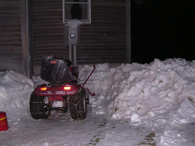

squonk 48,210 #5 Posted November 29, 2013 Believe it or not my 210 did a HUGE amount of work in the 20 yrs. I owned it Besides mowing I plowed quite a bit of snow. After the superstorm of 93, I got and old Allis-Chalmers blower attachment and made it work on it and it did a great job. All I ever fixed on it was a charging diode and a tie rod end. They are great little tractors. Just not real popular. Share this post Link to post Share on other sites

squonk 48,210 #8 Posted November 30, 2013 As far as a Snow Blower goes, After that big 93 storm I went to the dealer where I bought the tractor and wanted to by a blower. They said I was wasting my time that the little 210 wouldn't work good with a blower. What did they know anyway. They were Big JD guys and sold Toro for a 2nd line. I got the Allis blower for $100. I copied the snowplow mounting and made a 2nd bracket that the blower would fit on. Welded on another bracket for the lift rod to hook to. The blower was for horizontal drive so I just gave the belt a single twist. and rigged a pivoting spring loaded tensioner pulley. I used a Kevlar lined belt and that was it. Pretty simple really. I see those blowers all over. Same as Simplicity. Tat blower gave no trouble and moved lots of snow! Share this post Link to post Share on other sites
