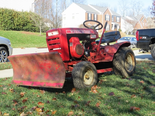

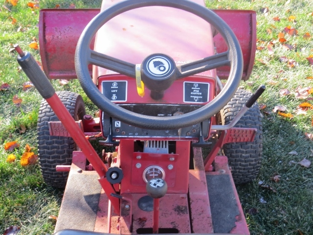

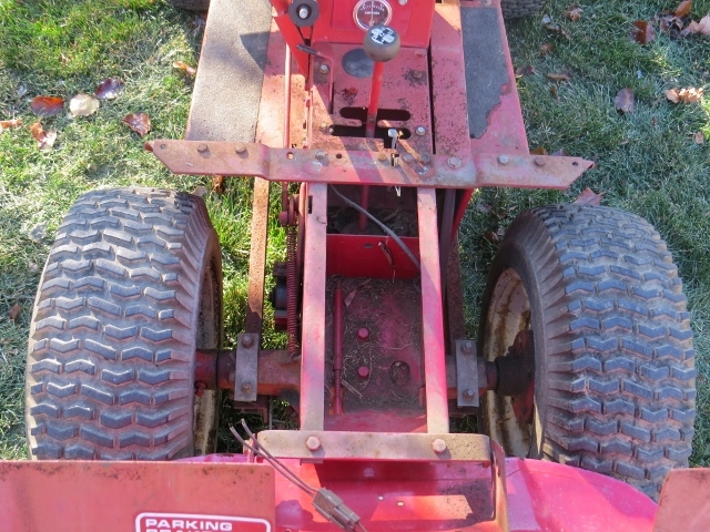

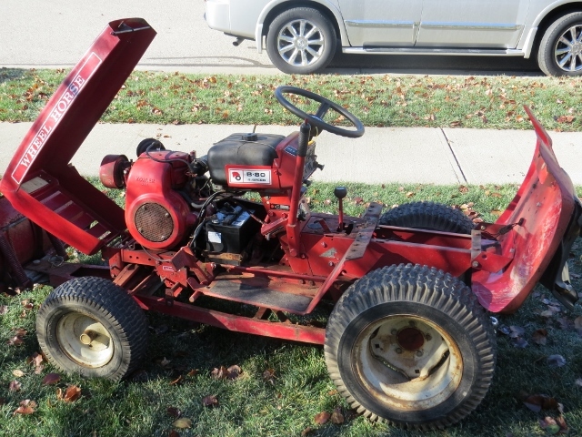

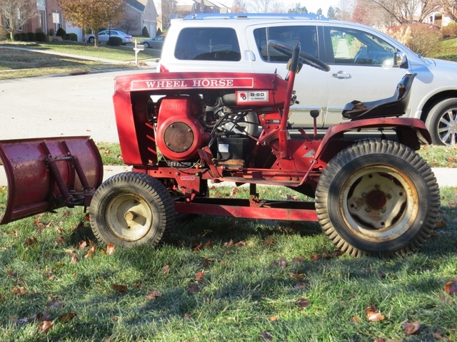

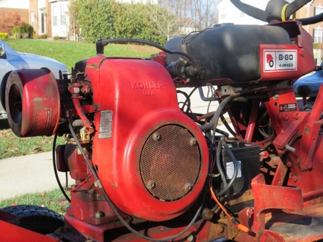

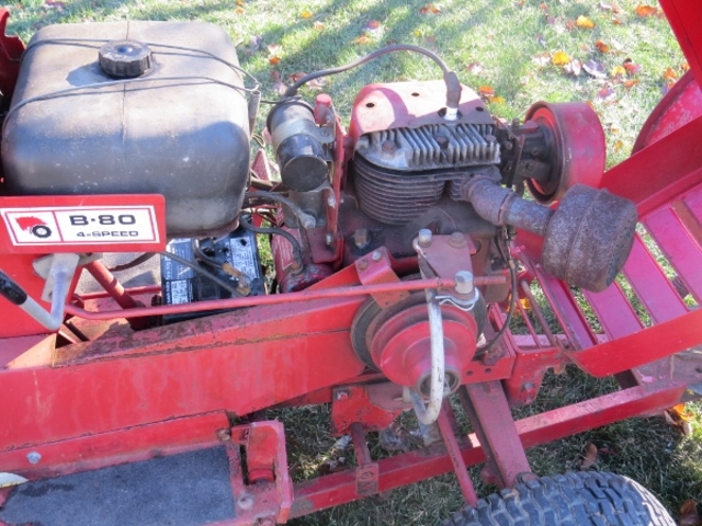

clipflip 10 #1 Posted November 28, 2013 I decided to go for it and pick her up! I think at $180 it was a steal! It runs perfectly and starts right up! BUT, it smokes pretty bad. The cylinder is in good shape, no scoring. I need to hone it out to .10 over and it needs a new piston and rings. Im not even going to touch the carb cause its perfect. PS... HAPPY THANKSGIVING!!! Share this post Link to post Share on other sites
clipflip 10 #2 Posted November 28, 2013 Pictures... 2 Share this post Link to post Share on other sites
AMC RULES 37,259 #3 Posted November 28, 2013 Looks good, and nicely priced too. 1 Share this post Link to post Share on other sites
clipflip 10 #4 Posted November 28, 2013 more pictures... even more... 1 Share this post Link to post Share on other sites
Sparky-(Admin) 26,206 #5 Posted November 28, 2013 Have you checked the oil? Maybe its got some real thin oil in it. I would warm it up, drop the oil and re-fill with some straight 30w. It might still smoke but maybe not as bad. Mike........ 1 Share this post Link to post Share on other sites
clipflip 10 #6 Posted November 28, 2013 Yeah, its kind of thin... But i took the head off and cranked it, oil just flows into the upper cylinder. Probably a spoonfull every 30-45 seconds. Its pretty bad. Share this post Link to post Share on other sites
