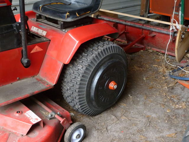

over60pirate 24 #4 Posted December 24, 2013 I took a 1/2" x 2" piece of steel, and welded a 1" section of barbell bar, to it. Then drilled a hole in each end and bolted it to the wheel. Behind the 50# weight are 35#'s. You might bake a center sleeve to use this method. Removing weights is fast. Share this post Link to post Share on other sites
