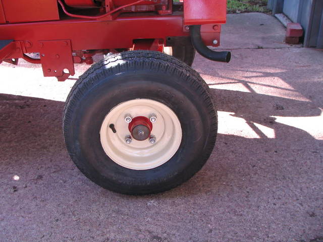

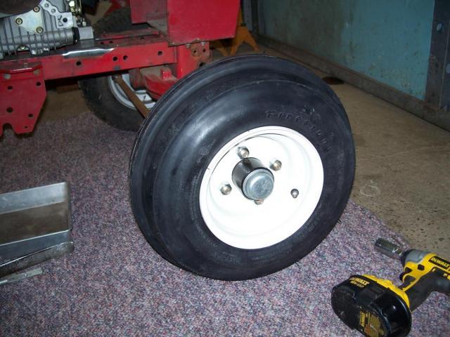

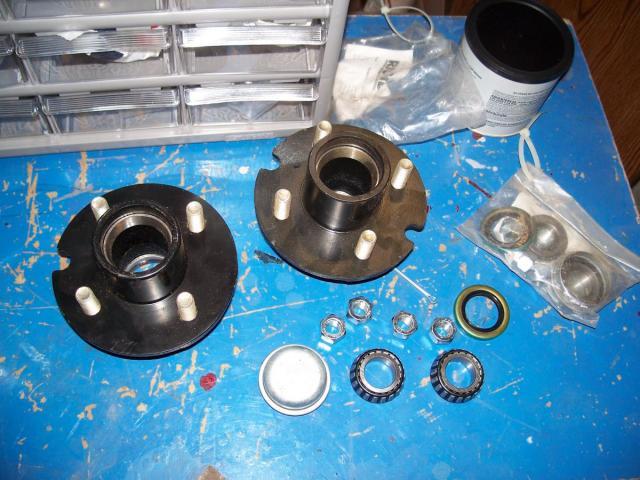

Lars 526 #1 Posted November 27, 2013 Hey.. i have done some upgrade on the horse and put on 4 bolt's on the front wheel's.. i have been thinking of that for a long time but never found the right part's for it.. but i finaly found a trailer hub kit that i bought... So here are som pict of what i did.. that axel was about 10 inch long so i had to cut it down to the right lenght.. and then i drilled a hole innside it about 1.5 inch and then it fit's on the original 3/4 spindel. And time to cut some more and both ready for some welding Finish whit welding time to try them on the tractor.. and as you can see they also has a greasepoint.. had some 10 inch trailer wheels that i put on so i could move the tractor and wait to ill got the other tires mounted on the rim's and finaly they are on the tractor Going to paint the rim's later dont have the time to fix that atm.. other project's whit higer priority.. Lars 14 Share this post Link to post Share on other sites

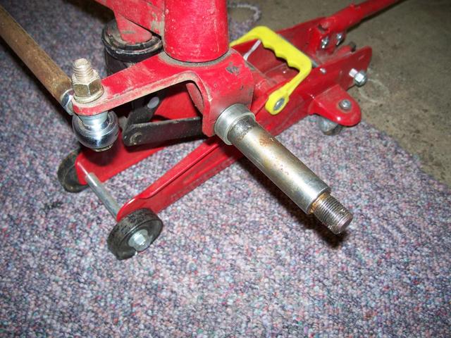

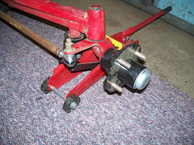

fireman 1,022 #4 Posted November 27, 2013 Don't mean to hijack your thread but I did the same thing this spring but went one step further. The 3/4" original spindles are inherently weak so I added a piece of steel to beef it up so they don't bend over time. Just thought I'd add this tip for you or anyone else who plans on doing this. I've seen others do this modification without the additional support and over time they tend to bend upwards with larger or wider tires added. I also bored out the new spindles so that the entire original spindles fit down deep in them instead of cutting them short. 7 Share this post Link to post Share on other sites

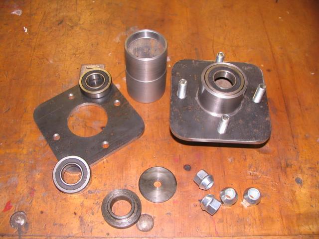

pacer 3,180 #6 Posted November 28, 2013 Both those mods are neat! and shows 2 different approaches... I'll add a 3rd one to the mix (I bet somebody will get some ideas from one of them - or all!) I took the method that forum member juss10 used and made mine from scratch -- heres a couple pics 3 Share this post Link to post Share on other sites

953 nut 68,882 #10 Posted November 30, 2013 A few years back I had a 3/4" spindle that was badley worn so I picked up some steel 1" OD by 3/4" ID mechanical tubing, heated the tubing to expand it and presseded it onto the bad spindles. Then I put brass bushings over that at the axle seal area. Trailer hubs went on and a fender washer and grease cup took care of the outside end. Fireman makes a good point about reinforsing them, may do that. Share this post Link to post Share on other sites

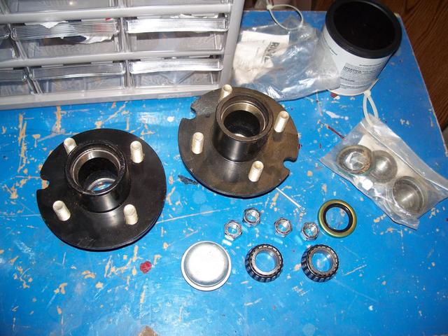

Kelly 1,038 #13 Posted December 28, 2013 This swap is real easy on a 520 with the swept axle no mods at all, Moat trailer shops will carry 1" hubs my local TSC has them, only thing I had to buy extra was a few 1" shim washers so when the castle nut was adjusted a cotter pin fit in the slots in the nut, then I bought golf cart rims that are 5 3/8" wide like the stock rims, these are centered for the offset but you can get other offsets, I have done this to a couple 520's, well axles that is, this set up is on my C-195 diesel project but has a 520 axle in it. 2 Share this post Link to post Share on other sites
leeave96 496 #14 Posted December 28, 2013 Kelly - I was at both tractor supply and northern tool last night. The smallest diameter hub TCS had was 1-1/16 and the smallest hub I could find at northern tool was 1 inch, but the seal diameter was 1-1/4. The seal diameter on my 520H spindle is 1-1/8. With the tires, hubs and rim offset you used, is here any interference with the mowing decks? Thanks! Bill Share this post Link to post Share on other sites
Kelly 1,038 #15 Posted December 29, 2013 (edited) If it's only a seal issue go to Napa or other good auto parts store and find a seal, I don't mow with my 520's I have a nice little 265H that does my mowing. Are you sure your sealing area is 1 1/8" ?? just looking at my pic above it looks bigger than that, the seal ring also slides off the spindle Edited December 29, 2013 by Kelly Share this post Link to post Share on other sites
leeave96 496 #16 Posted December 29, 2013 If it's only a seal issue go to Napa or other good auto parts store and find a seal, I don't mow with my 520's I have a nice little 265H that does my mowing. Are you sure your sealing area is 1 1/8" ?? just looking at my pic above it looks bigger than that, the seal ring also slides off the spindle Definitely 1-1/8 diameter. Good idea on napa. I probably could cross/use the same seal on the stock rim. Share this post Link to post Share on other sites
sorekiwi 761 #17 Posted December 29, 2013 Surplus centre has hubs to suit a 1" spindle. http://www.surpluscenter.com/Wheels/Spindles-Wheel-Hubs/5-BOLT-LOW-SPEED-HUB-W-BEARINGS-1-3747.axd These are 5 bolt hubs that I bought for my JD front axle, but they do a 4 bolt as well. Fairly sure that Northern has them as well. 1 Share this post Link to post Share on other sites

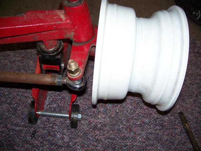

JoeM 10,205 #20 Posted January 5, 2014 I went a slightly different way. I purchased a set of 520H front axles on e-bay, bored the original front axle to 1" and installed the new 1" units with 4 bolt trailer hubs, wheels and tires. 1 Share this post Link to post Share on other sites
