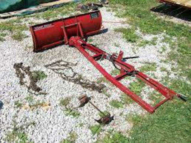

I'm gonna pick up a front blade system on Wednesday and want to make sure it will fit my C-160. The blade is a model #: 6 9622 8 / Serial #: 758975. It comes with everything to mount it up to the rear axle including a set of rear tire chains. I already have the quick attachment mounts on the axle of mine for the tiller. Are the mounts different? The main question is...will it work/fit?  Here is a pic of it. Thanks, ya'll are the best! - Ben
Sparky
Pic is kinda small but it looks like a long frame plow frame so ...yes...it will fit your C-160. the rear axle bracket for your tiller is the same as for that plow.
Mike.........
benjiboo
Mike.........
Sweet!!! What would you estimate the value of this to be. In other words, what kind of offer should I make on it? He's asking $175 but said it's negotiable. Is it worth the asking price as long as it's not all roached out and bent all up?

Trouty56
Try to negotiate a little...part of the fun for both sides......I think 150 is a good solid price.....

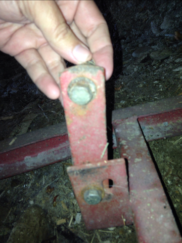

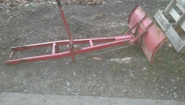

Ok folks, so I went and got the blade today. I wound up giving $150 for it. All I got is what is in the picture. Apparenlty the picture he had on Craigslist was a pic he swiped from somewhere else on the net, which is kind of somewhat shady but....at least the one he had was in as good of shape or maybe even better. Everything is tight and the cutting edge still looks new except alittle rust. I really don't think it has been used all that much. Anyway...on to the picture. Lol.

leeave96
Nice looking blade. You will need the rear hitch to mount it and if you don't have it, a short link to the lift and you're in business.
benjiboo
Mine has already got the rear axle implement mounts bolted on for my tiller. I assume the part that raises a deck up and down under the tractor is what hooks up to the blade arms. There is a short link on the blade arms in the center that is right around the area where it would all hook up so I suppose thats what your talking about?
i967mustang
My plow has a solid link on it so it won't float like a mower deck. Most of the plows either had a chain so it would float or a solid link that doesn't float. On mine the mower lift rod was too short to reach the blade so I got the solid link.
varosd
you will need the silver link to hook up to the chain or threaded rod.
there was a long solid link option that would replace your chain, like stated above that allowed you to apply down pressure. other folks will chime in on OEM or homemade solid link.
shallowwatersailor
I used a piece of 3/16" x 1" flat stock to make one for my C-105's plow. Without measuring it, I think it was about 4 1/2" long, or that was the hole spacing. I can measure it later if you want. It is a lot cheaper than buying the part.

benjiboo
benjiboo
Can you measure the rail length and width for me.  I have a 312-8 and Wheel Hose products are hard to find and was thinking of adapting an ATV Plow.
Thank you!
The measurements I got are as follows:  From the blade pivot to the rear cross bar that mounts in the quick attachment is 64", the inside width at the widest point (rear where it mounts) is 11 1/2", with the blade turned either direction there was approx. 3" clearance from the front tires pointed straight forward. Hope that helps.
benjiboo
Well Folks, I actually got the blade mounted up today and got to try it out. I had some dirt that was bermed up pretty good from the kids riding their 4-wheels in the side yard and wanted to level it all back out. All I can say is WOW! The dirt has been bermed up for a while so it was packed down pretty good though not as much as virgin soil. I leveled it all back out and the tractor never once wimpered or stuggled. I was pushing in 1st.-High range. If anyone is curious about getting a blade for their's and can find one I say go for it, you won't regret it a bit. :music-rockout:
